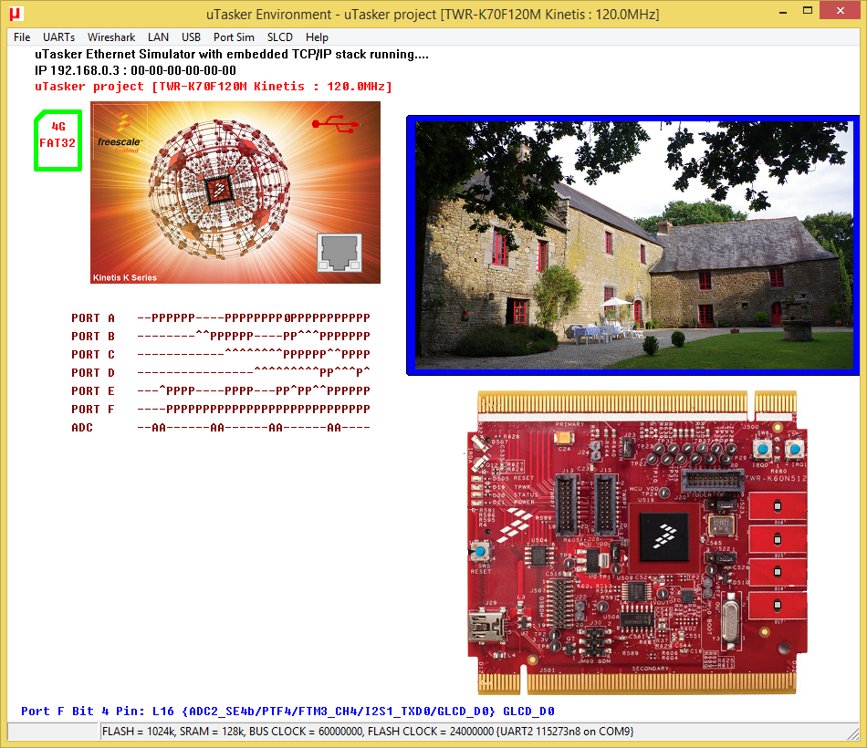

I finally got around to configuring the TWR-RGB-LCD on the TWR-K70F120M and have attached a binary that you can load to your board to veriy that you have no HW problems.
If there is no SD card inserted (or no "pics" directory available on it) the LCD will show some graphics (images, animation, text).
If you insert a FAT32 formatted SD card with a directory called "pics" you can put in a quantity of 24 bit colour bit maps (480 x 272 in size or smaller) and these will be displayed as a slide show (when the K70 detects the SD card and the directory after a reset).
The tower is also contactable on the IP address 192.168.0.3 and has an FTP server which can be used to copy the files to the SD card if you want to copy them during operation.
Furthermore, the SD card shows up as a hard disk if you connect the TWR-SER's USB connector to the PC and so the images can also be copied from there.
The slide show doesn't use a second window and swap so that the updates are instantaneous but simply redraws the screen. This allows the actual SD card read/LCD write speed to be visible.
The binary can be copied to the board using CodeWarrior's "Flash File to Target" Utility.
Essentially it shows that the SD card operates well together with the TWR-RGB-LCD module; I had no problems with HW or any port conflicts etc.
For configuration and testig I used the uTasker Kinetis simulator - a screen shot is shown below testing the SD card and TWR-RGB-LCD operation.
