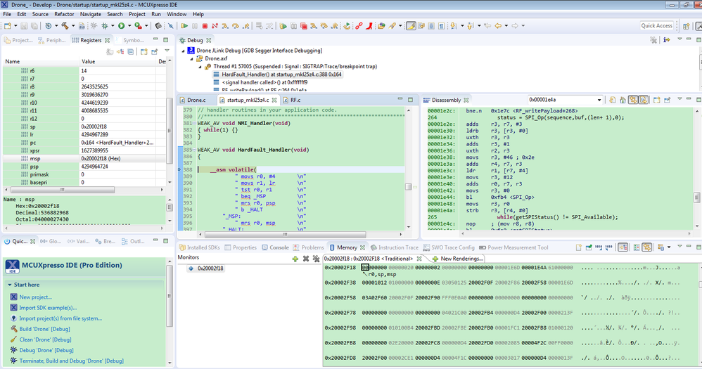

Hello Kerry, yes the problem was caused by the SPI.
I was using KDS 3.2 and i decide to move my project to MCUXpresso. There it gives a HardFault, and it happens only in the Function sendPacket but only the second time that i want to use it, this function works with the SPI, but when the ISR finish his work and want to return, it give me the HardFault, In this moment i'm unable to send you a picture, but i apreciate your help, in the next hours i'll try to take the picture and post it!

I was making tests yesterday, and i saw that the problem is when i try to write the array named packet placed in the function sendPacket as follow:
uint8 packet[32], index;
packet[0] = 0xFE;
packet[1] = len;
packet[2] = cmd;
When i got there i try to execute it, gives me the Hard Fault.

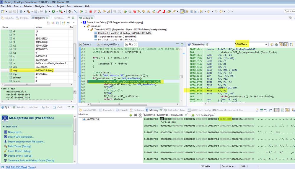

Hi Saul,
   After checking your code, I locate the detail function line which caused the hardfault.
The main problem is:
status = SPI_Op(sequence,buf,(len+ 1),0);
When SPI_Op return back, the returned data is 2, and when 2 gives to status, the hardfault happens.
The according asm code is :
00001e48:   movs    r3, r0
00001e4a:   strb    r3, [r4, #0]
So, that's really very strange, I am still working on it.
Any updated information, will let you know.
Kerry

Thank you for your updated information.
  What's the detail line in your code caused the problem, did you locate the specific point?
  Please give the picture which shows the problem when you debug it.
  Besides, I find you are using the SPI module, whether the problem caused by the SPI?
Kerry
