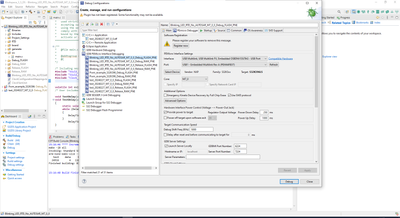

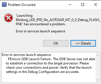

I have this error when I try to debug the S32K396-LQFP-DC :

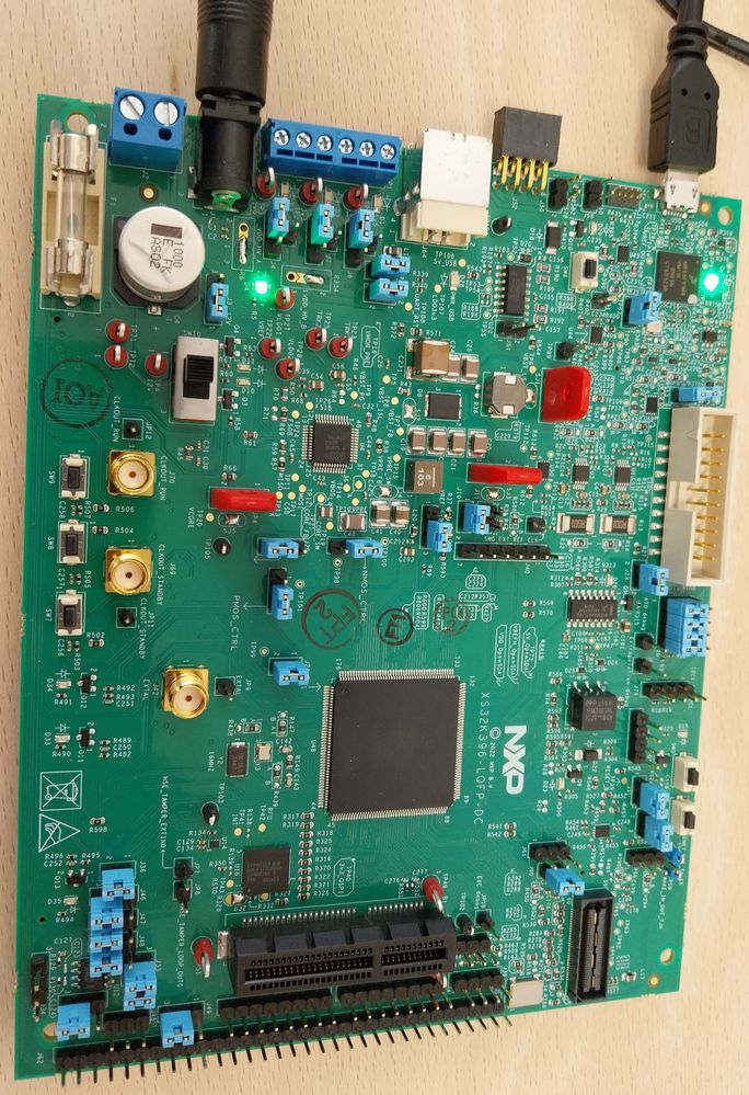

This is how I connect the board :
Could you help me please ?
Thank you.

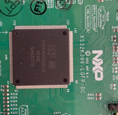

lukaszadrapa
LQFP is supported in RTD 4.0.0. You should see this version in the Standard Software package:
https://www.nxp.com/webapp/swlicensing/sso/downloadSoftware.sp?catid=SW32K3-STDSW-D

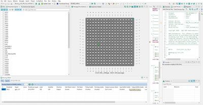

Silvano
I finally succeed to communicate with the board, thank you. I have a last question, where can I find the coorect package for the S32K396-LQFP-DC ? Because I have only package for the S32K396_289bga-BGA 289 package. So when I try to compute the code example " Blinking led" , I can not see the led blinking.

lukaszadrapa

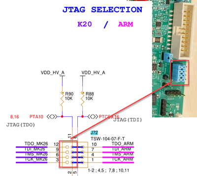

Silvano
Hi @lukaszadrapa
Where may I find the schematic that you use in your message ? I have the spf-54614_a.pdf version.
Also, which jumper configuration do you suggest for in-built OpenSDA interface ?

lukaszadrapa
Hi @Silvano
if you use in-built OpenSDA interface, you need to select it by jumpers. I can see that ARM connector is selected now:
Regards.
