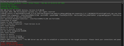

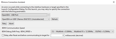

I try to send the hellowolrd example in the SDK (twrkv46f150m_hello_world), but when i build the project, everysing is done with no warning, and when i lunch the debug i have this window :
i try to find the correct BDM speed but i didn't successed, so i try all of them. No success.
So i search more information and i find this error:
Error in services launch sequence
PEmicro GDB Launch Failure : The GDB Server was not able to establish a connection to the target processor. Please check your connections and power. Verify that the launch settings in the Debug Configuration are accurate.

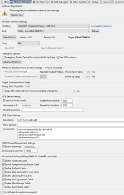

But I don't know how to set up the server, this is the actual config:
So since I don't know anything about GDB servers, I was interested in the flashing error. And I have this error report:
Executing flash operation 'Program' (Program file into flash: twrkv46f150m_hello_world.axf) - Fri Sep 29 09:45:16 CEST 2023
Checking MCU info...
Scanning for targets...
Executing flash action...
P&E GDB Server for Arm(R) devices, Version 9.30.00.00
Copyright 2018, P&E Microcomputer Systems Inc, All rights reserved
Loading library D:\Nxp\MCUXpressoIDE_11.8.0_1165\ide\plugins\com.pemicro.debug.gdbjtag.pne_5.7.1.202309212104\win32\gdi\unit_ngs_arm_internal.dll ... Done.
Command line arguments: -interface=OPENSDA -port=USB1 -speed=5000 -flashobjectfile=D:\MCUXpressiIDE_11.0.8\twrkv46f150m_hello_world\Debug\twrkv46f150m_hello_world.axf -device=NXP_KVx_KV46F256M16 -programmingtype=0 -runafterprogramming -startserver -singlesession -quitafterprogramming
Device selected is NXP_KVx_KV46F256M16
User Specified Hardware Selection : Interface=OPENSDA and Port=USB1
Connecting to target.
Unable to load libusb0.dll
OpenSDA detected - Flash Version 1.08
Can not enter background mode.
Unable to initialize PEDebug.
Target Disconnected.
Flash command failed!
Unable to perform operation.

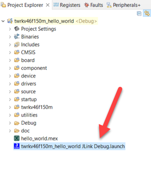

I try to delete the .launch file and reload/build the project.
I can still see the detection of the SDA probe, but I still have the PEmicro assistant coming after it. (and all possible config doesn't work).

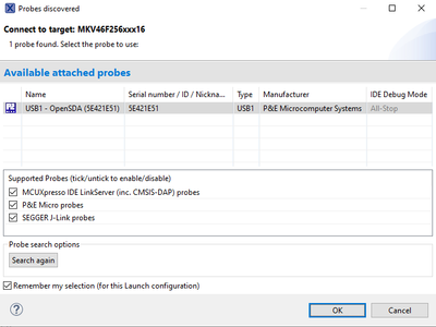

The probe avalable for me :
And I click "OK", I'm stuck at this step : HGRR_1-1696581512741.pngHGRR_1-1696581512741.png

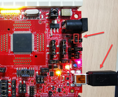

EduardoZamora
Could you please try shorting J518-1 to J517-2? Also, connect the USB cable to J511:

HGRR
I shorted J518-1 to J517-2, connect the USB and retry the procedure of your message below.
But it's the same probleme I don't know why

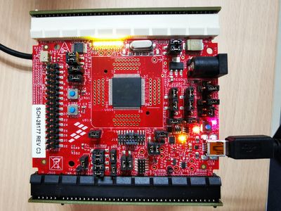

EduardoZamora
Hello @HGRR
Could you please help us providing the jumper configuration of your dev-board? A picture of the top side of your board would be very helpful.

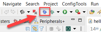

Please, try deleting the existent *.launch file from your project.
After this, click on debug with the active build configuration.
This should start the probe discovery. The available probes should be listed here, select the probe corresponding to your board and try debugging again.
