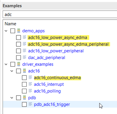

You can refer to the app note AN13802 (FlexTimer Module Synchronization with ADC and DMA) and at the same time take as reference the SDK examples for the frdmkv31f:

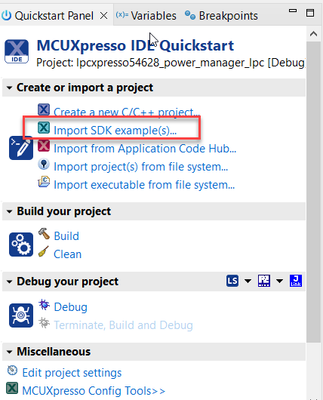

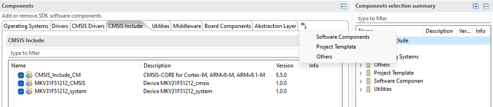

In MCUXpresso IDE no have example programs and how to exam files to open?Screenshot 2024-02-08 201013.pngScreenshot 2024-02-08 201013.png
                            Thank you
PANDI
2,706 Views
_Leo_
You need to import an SDK example:
Just make sure to select a board (not a part, parts do not have examples), in your case please select the FRDM-KV31F.
