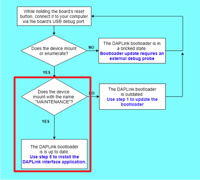

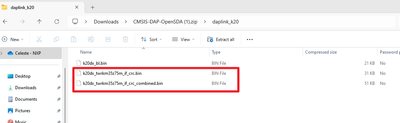

1,459 次查看
Celeste_Liu
Hello @Mr7 ,
Thanks for your post. I did a test on my evb board, with no problem.
However, I noticed that the orange LED D2 stays ON instead of LED D9.
Please check my status under MSD, which should be mounted with the name TWR-KM35(D:), instead of showing "maintenance".
Please refer the DAPLink bootloader update | Mbed to check.
When your device mount with the name "maintenance", you need install the DAPLink interface application, just open the device's root directory then drag-and-drop the firmware update into this directory. The firmware is attached.
Hope it can help you.
