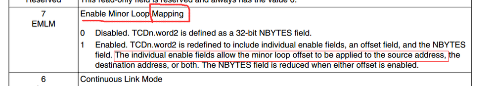

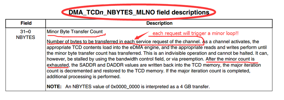

  1. the value in the register TCD Minor Byte Count (Minor Loop Disabled) (DMA_TCDn_NBYTES_MLNO) is Minor Byte Transfer Count,not the bytes Transfered in Major Loop
sorry, just now, i upload the wrong picture!!

AS to the difference  between DOFF and using the NBYTES_MLOFFYES offset?
DOFF means the offset added to DADDR after every write to DADDR. But NBYTES_MLOFFYES offset means the offset added to DADDR after every minor loop if enabled.And one minor loop may include many times write.
you can see the example in the RMhttp://cache.freescale.com/files/microcontrollers/doc/ref_manual/K22P121M120SF7RM.pdf?fromsite=zh-Ha... P505
and you will get it.
5,843 Views
MinkerF
oh, i get it
if you diable the minor loop remapping,the you shoud config DMA_TCD0_DOFF=4.
Or if you enable the minor loop remapping,then you should config the NBYTES_MLOFFYES
as showed the flowing two:

no,MLNO is dosn't mean minor loop disabled!!  it means the remapping upon the minor loop completion!  just like the remapping upon the major loop completion!
as to but the MLOFF offset doesn't add to the DADDR register.this is because,you enable the ninor loop remapping,but you don't set the MLOFF in value.
