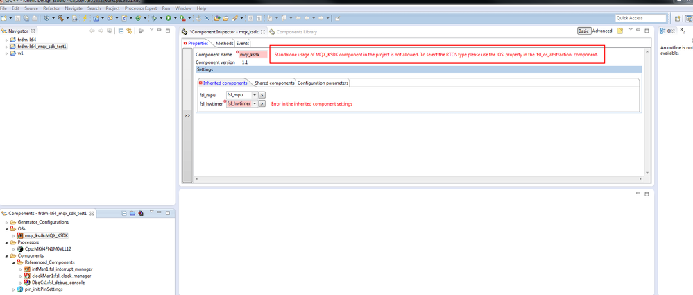

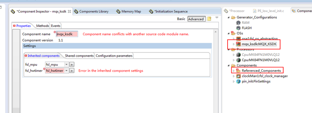

I use KSDK 1.1.0 and KDS 2.0, After i create a Kintetis Design Studio project, I select a MQX_KSDK compoents library to add to project, after i change osa1:fsl_os_abstraction OS name from BareMetal to the MQX_KSDK,  mqx_ksdk:MQX_KSDK components have a error "Component name conflicts with another source code module name. (Component name) mqx_ksdk/Component nameProcessor Expert Problem"
,i do not know how to To solve this problem

Hi Junfeng,
When  use MQX_KSDK,  it needn't add the mqx_ksdk component,  we  only need choose here :
this function is equivalent to MQX_KSDK.  There are all the OS the KSDK concluded, we can refer to our need select.
And I test only use the mqx_ksdk component, it show this error below :
So, please do as i said.

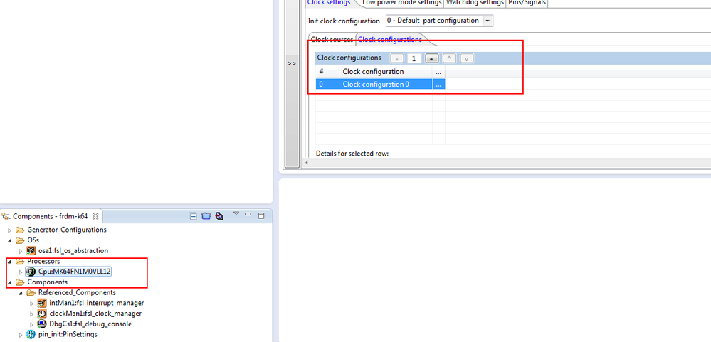

Another point, if  there are more than one clock under "Clock configuration", please click the "-" to only one.
like this :

Hi  Junfeng,
Do you mean change here :
can you show your screenshot about  your configration , or it is difficult find your problem.

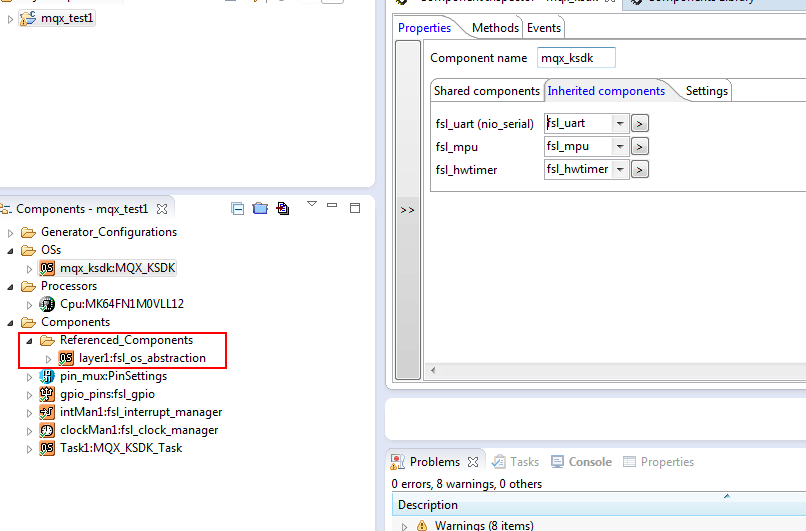

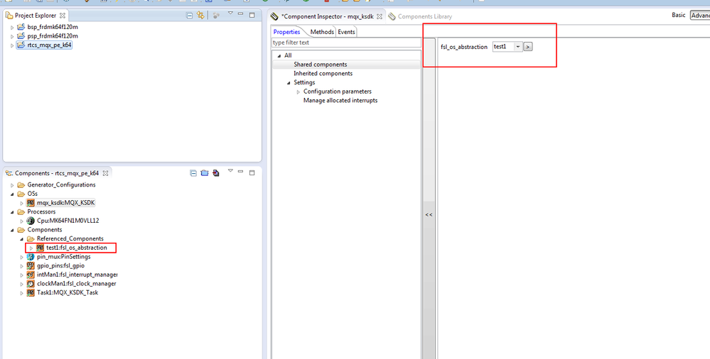

Hi Feng,
From your screenshot  error :
I think there two fsl_os_abstraction, you can expand thte "Referenced_Components" , see where is error ?
When you create the project , there have fsl_os_abstraction component .  Do you need two fsl_os_abstraction component ?
Below  attachment is on my side test ,  if you want, you can send the error project to me .

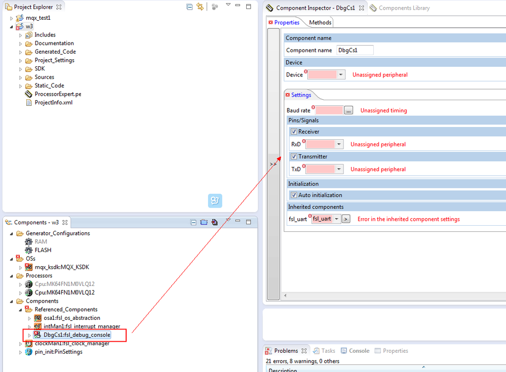

Hi Feng,
I have check you project, and many place you haven't configration,   for example :
and else.
Use the PE, you can configration refer to its error.
And the attachment is a simple code , and it can work on my side , you can try it ,if ok, you can go on you application on it.

俊峰王
See the attachment picture,all is create by PE,is it correct?

俊峰王
I reinstall KSDK 1.1.0 and KDS 2.0, checking update in KDS, delete workspace , recreate new project, error still there.
I find your picture diff with me ,it is same version ?
the attachment have simple new project code.
