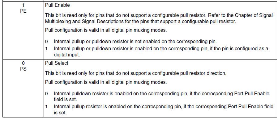

You can find the table on the page 185 in the attachment.
1. Internal pullup or pulldown resistor is enabled on the corresponding pin, if the pin is configured as a digital input."  Now, if the pin is configured as an output does this still work?
No, it will be disabled.
2. From reading this cryptic table I guess that both PS and PE have to be used to set the pullup or pulldown resister?
Yes

I noticed that the PE 1 "Internal pullup or pulldown resistor is enabled on the corresponding pin, if the pin is configured as a digital input."  Now, if the pin is configured as an output does this still work?  From reading this cryptic table I guess that both PS and PE have to be used to set the pullup or pulldown resister?
John

Many pins are allowed to be pulled up with the internal pullup resistor, and you can configure the kind of feature through the PE and PS bit in the PORTx_PCRn register.
Ping

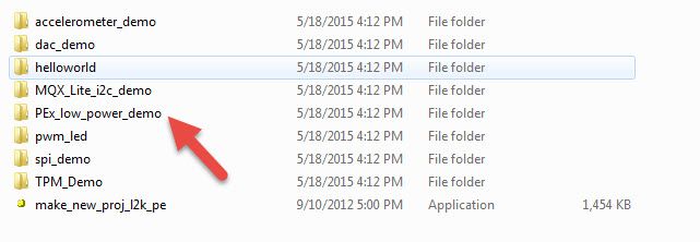

Downloading the sample code package flow:
  1. Click the 面向Kinetis KL的Freedom开发平台|恩智浦
  2. Download the sample code package
  3. After install the sample code package, you can find the PEx_low_power_demo which integrates with the PE.2016-05-11_10-46-35.jpg
Hope it helps.
Ping
