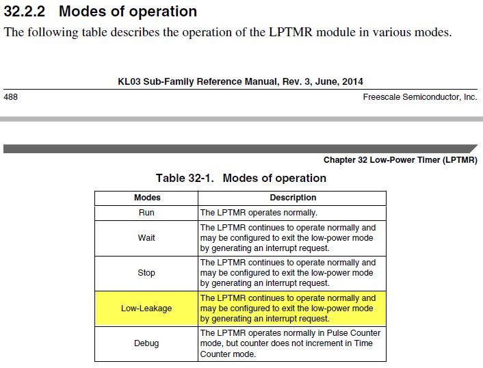

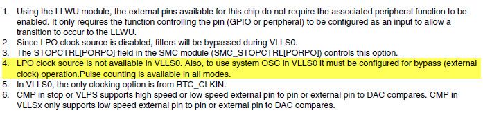

LLWU is a peripheral in the MCU, that is used to wake from the low-leakage stop modes, LLS and VLLSx (note that the KL03 does not support the LLS mode).  And yes, the LPTMR can wake the MCU from those low-leakage stop modes, see snippets below from the KL03 reference manual:
