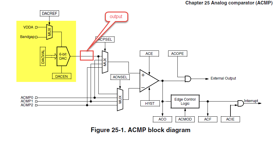

hellow,I want use the DAC module of  kea128 to put out the analog signal which will be used as the sensors signal.
The datesheet has been stated:This stepped analog output is also mapped out of the module.But I did not find  the map.
Can anyone tell me where the mapping is?

Hi Longji Li,
   Maybe that description is misleading you.
   Actually, the 6-bit DAC don't have the output pin in the MCU, the content in the reference manual:
  Take care,  it is map out of the module, not the chip. It just means the DAC output have the output from the DAC modue, this output can be used by other module, like CMP.
   So, this DAC is just used by the CMP, it don't have the output pin in the KEA chip.
Wish it helps you!

Thank you so much!
