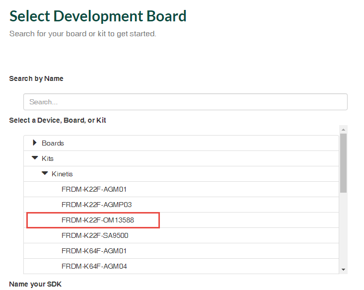

We are using OM13588 USB Shield board for some USB PD evaluation. As per the user document, PD control is through Kinetis KL27Z. Just wanted to check if we can use K22F FRDM board with the shield board. We have already tried using it. Used MCUXpresso IDE to generate the SDK for PD and tried to run it. However PD part does not seem to work.Any advise?
736 Views
Hui_Ma
During the MCUXpresso SDK Builer process, customer need to select the [FRDM-K22F-OM13588] board:
Then, customer need to refer each usb_pd project <readme.pdf> file for detailed board setting.
Wish it helps.
