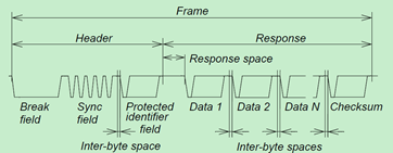

   Actually, in the master publish mode, break filed+sync field+ID+ datas+checksum, all the data are sent by the LIN master.
   In the master subscriber mode,  break filed+sync field+ID is sent by the master, the data and check sum is sent by the slave.
  The LIN frame just like this picture:

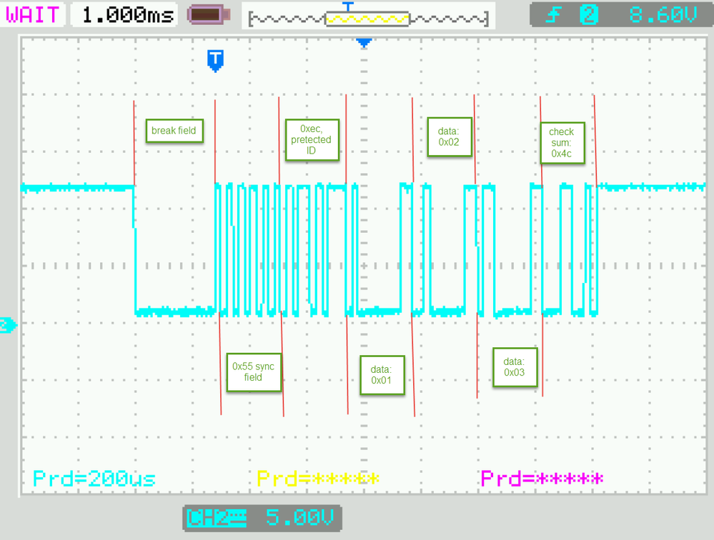

  You can refer to my post about the LIN slave understand the frame:
KL series LIN slave simply usage sharing
From your picture, It seems your master configuration still have problem, I don't know what the data mode your master have sent.

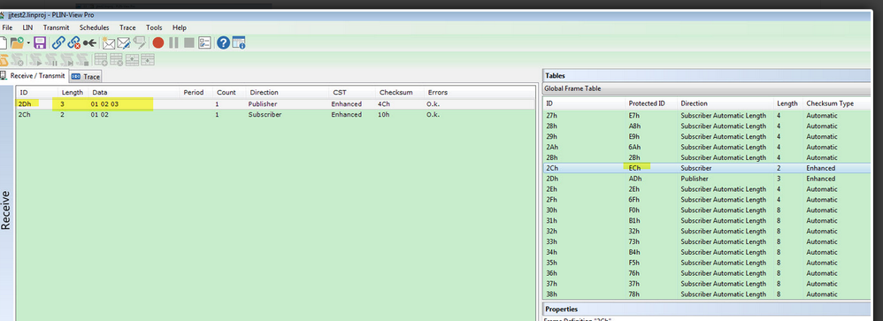

My post also use the CANUSB to send the LIN frame, you can see my send data, and the oscilloscope wave, it is correct. You also can send the publish frame:
Break field+sync filed(0X55)+0X2D(Protected ID 0xEC) +0X01(data0)+0x02(data2)+0x03(data3)+0x4c(checksum)
So, now, I think if you can't find the ID from the LIN bus, the problem is caused by your master, you need to check your master configuration.
