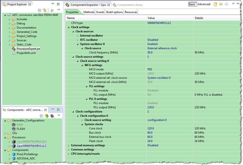

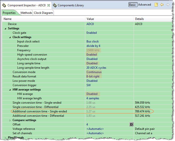

Robin_Shen
No. In order to get 18MHz fADCK, I am not using 120MHz core clock in that demo.
I have modify that demo for you to refer: 120MHz Core \ 60MHz Bus \ 15MHz fADCK
Robin
