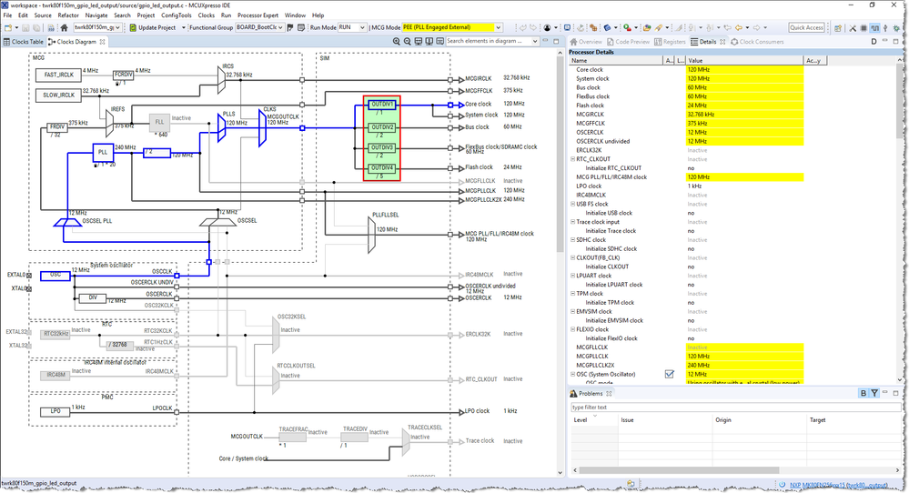

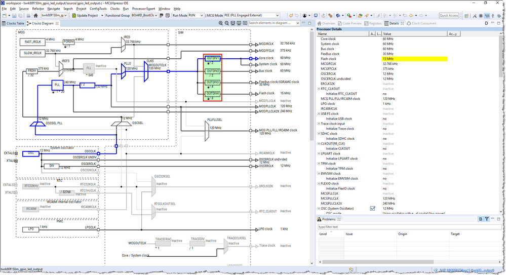

Robin_Shen
I am using Clocks tool of MCUXpresso IDE, the GPIO example is able to run after modify the divider.
Robin
