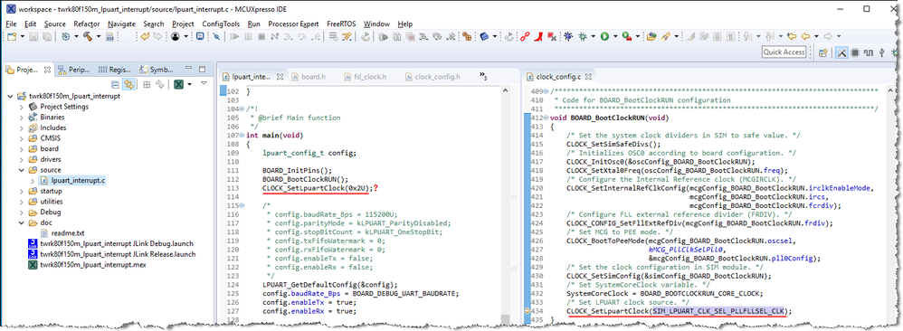

That's really usefull feature in MCUXpresso and now i'm able to set SIM_CLKDIV1 correctly but i noticed that's not perfect.
Not sure if it's bug or i'm doing something wrong but if i want to clock my UART using this tool it's not working properly, wrong clock is selected.
How it's setuped:
Register values in clocks tab :
What i get after i run the code:
And the problem is not only when i want to use PLL to feed UART, it always end up with OSCERCLK clock.
2,297 次查看
Robin_Shen
Please check if there is someplace else select the clock of LPUART again.
For example: the lpuart_interrupt will select OSCERCLK after BOARD_BootClockRUN
