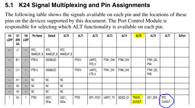

1. I understand from the reference manual that we can check the system/core clock using trace_clkout on PORTE 0th pin.  Please correct me if I am wrong.

Hi Sachin
The clock sources that can be connected to CLKOUT are
Beware that PTE0 is RTC_CLKOUT and not CLKOUT. CLKOUT can be assigned to either PTC3 or to PTA6.

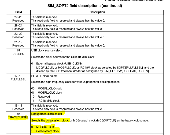

I also noticed that there is trace clock selection option (TRACE_CLKOUT) available on 1st pin other than the RTC clock.
Q. How is trace clock different from clock out ?
    a. Is it correct to understand that trace clock can be used only when I boot my system with the debugger and clock out (CLKOUT) can be used in normal run mode?
  b. Any advantage using one over the other (TRACE_CLKOUT vs CLKOUT)
Sachin
4,342 次查看
mjbcswitzerland
Specialist V
Sachin
I blieve that the trace clock is used when a trace module is connected for debugging - whereby the clock used as reference for that module can be selected.
As it states you could also connect the core clock to that pin, which would presumably allow it to be "observed".
