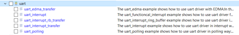

In addition I recommend to download our SDK for the FRDM-K22 and work with the uart examples as shown below:
You are able to use these as a reference for the configuration of the UART.
