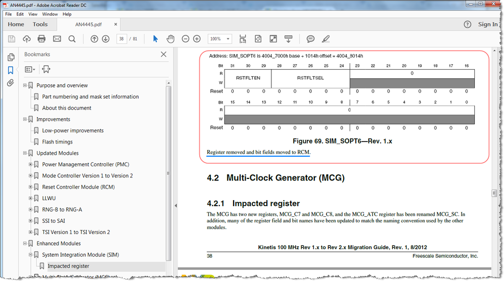

We have been using the MK10DN512ZVLL10 for years without problems. The latest micro receipts come without the letter 'Z' (MK10DN512VLL10) and the equipment is constantly being reset.
Following the program we have seen that it was reset when writing to the SIM_SOPT6 registry (hard fault interrupt). Looking at the datasheet of the new version of the microcontroller without the 'Z' we see that this register has been eliminated.
Eliminating the line that configured this register the microcontroller is no longer hanging on this point but the program ends up hanging equally later.
Can anyone (better if NXP could be) indicate the differences between the versions of the microcontroller and why so many basic things have changed so that the programs now are not compatible?

I certainly can't answer 'why', but I can confirm there are a LOT of very basic differences between the 'non Z' and 'Z' parts, including vector table and peripheral set.
Look for this document:  "AN4445 V1 to V2 migration.pdf"
What surprised me though is your designing-in of 'Z' chips in this 'day and age'.  The changeover to V2 silicon (No Z, full production mask sets) happened years ago (final rev of AN4445 08  / 2012)...

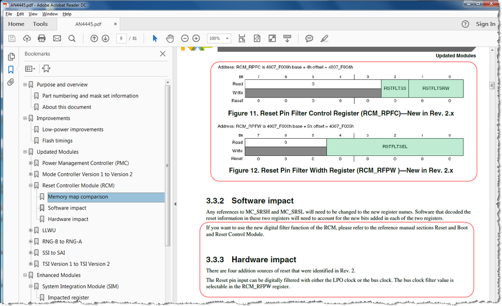

If you want to migrating from Kinetis 100 MHz Rev. 1.x to Rev. 2.x. It would be necessary to review all the differences that appear in document AN4445 to be sure that we will not have problems.(Hardware and software changes may be required.)
About the SIM_SOPT6, please read the AN4445 Kinetis 100 MHz Rev 1.x to Rev 2.x Migration Guide.
