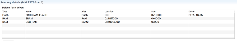

First of all, I know that this question has already been asked some times but my issue is not exactly the same as the former questions.
I am working with the FRDM-KL27Z board. For some reason, at a precise state, in debug mode, my program falls down in the HardFault handler function because It reaches the g_pfnVectors() at 0x0. I am not doing something too much sophisticated or complicated and the part of the code which is failing  works well on computers or smartphones. Weirder, when I override the default HardFault handler which is defined as weak by default, my handler is not reached and the g_pfnVectors, instead of redirected the code to the hardfault handler, jumps directly on the ResetISR handler.
It's a professional work so I won't be able to show you some code.
I read that it could be the synchronisation between the PC and the debugger (here) which could be the reason of that bug however when i remove the failing part, there is absolutely no issues.
To help, I precise I am working with MCUXpresso IDE with the newlib nano library.
Thanks for your help !

Hi all,
I finally was able to solve my issue !
In the code that was failing, I had a structure like that :
struct a_struct
      int32_t tab[512];
      int32_t tab_length;
The problem was that structure was statically allocated and used by reference a lot of times so at some point the stack was erased and corrupted by the "tab" value which was mostly filed by zeroes (the reason of the jump to the 0x0 address I think). By allocating dynamically this tab and reducing the tab type to uint8_t, the issue was solved !
Thanks to you two for having trying to help me =)
Damien

I configure the memory the following way knowing that I have 0x4000 bytes of RAM available:
   - 0x2000 bytes for the heap
   - 0x1000 bytes for the stack
   - The rest of the memory is used by the data
So when I compile, I've got that :
Memory region            Used Size        Region Size        %age Used
PROGRAM_FLASH:       61480 B                 64 KB              93.81%
                     SRAM:       16020 B                 16 KB              97.78%
              USB_RAM:             0 GB                 512 B                0.00%
Here are screenshot from my configuration :
Finally, I've worked on a FRDM-K22F board before and managed to load the binary into the board but with that one I can't load it.
