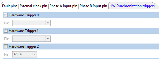

I've been trying everything I can think of to get quadrature decoding to work with my FRDM-K64F board, running KDS 2.0, KSDK 1.1, MQX, and a combination of PEx and bare metal code.
I started by using the fsl_ftm component with the following settings:
With these settings, FTM2_CNT is always 0.

I then found another post here on the forum that outlined the bare metal configuration.  So I changed my task code to configure FTM2 (perhaps it can't be done in a task?), and the results are the same.  Here is the code I used.  Note that I only modified registers where the already-set value by PEx looked reasonable.
void qd_task( task_param_t initial_data)
    static uint16_t counter = 0;
    uint32_t sim_scgc6 = SIM_SCGC6;
    uint32_t ftm2_mode = FTM2_MODE;
    FTM2_CONF |= FTM_CONF_BDMMODE(3);
    uint32_t ftm2_conf = FTM2_CONF;
    FTM2_MOD = 4095;
    uint32_t ftm2_mod = FTM2_MOD;
    uint32_t ftm2_cntin = FTM2_CNTIN;
    uint32_t ftm2_qdctrl = FTM2_QDCTRL;
    FTM2_SC |= 0x08; // use system clock
    uint32_t ftm2_sc = FTM2_SC;
    while(1) {
        if( FTM2_CNT != counter) {
            counter = FTM2_CNT;
After running up to the while loop, here are the register values:
sim_scgc6    uint32_t    0x64000001
ftm2_mode    uint32_t    0x5
ftm2_conf    uint32_t    0xc0
ftm2_mod    uint32_t    0x0
ftm2_cntin    uint32_t    0x0
ftm2_qdctrl    uint32_t    0xcd
ftm2_sc    uint32_t    0x9
Can anyone suggest something for me to try to debug this further?

Ok, so I think I have it figured out.  At least to the point where I'll be able to make some more progress.  My original theory about why FMT2_CNT wasn't getting updated was correct, and it all came down to FMT2_MOD.  If it's 0, the counter isn't going to increment.  Although that does make sense, it would be nice to see this in a note in the reference manual because it'll probably help out some people.
But perhaps more importantly, I feel like it would have been nice to make the updating process of FMT2_MOD a little more clear.  I followed the flowchart and set the registers as indicated, but could never get the register to update.
In the end, I used the following method, which was so obvious and easy, yet it took me at least two days of banging my head against the wall to realize how it could be done.  And as far as I could tell, the manual doesn't offer this option in a note.  It's definitely implied, but sometimes just telling the user something directly is a nice thing to do.  :smileyhappy:
The solution is to simple disable FMT before setting FMTx_MOD.  That's it.
Here's all you have to do:
  • FMT2_MODE |= FTM_MODE_WPDIS_MASK (disable write protection)
  • FTM2_SC &= ~0x18 (disable FMT)
  • FTM2_MOD = 0xFFFF (set to max value)
  • SIM_SCGC6 |= SIM_SCGC6_FTM2_MASK (not sure which really enables FTM2 gate)
  • SIM_SCGC3 |= SIM_SCGC3_FTM2_MASK (not sure which really enables FTM2 gate)
  • PORTB_PCR18 = PORT_PCR_MUX(6) | PORT_PCR_PFE_MASK (PEx should have done this, though... need to check)
  • PORTB_PCR19 = PORT_PCR_MUX(6) | PORT_PCR_PFE_MASK
  • FTM2_SC |= 0x08 (enable FMT with system clock)
Now you'll be able to see FMT2_CNT change when you spin the encoder.
