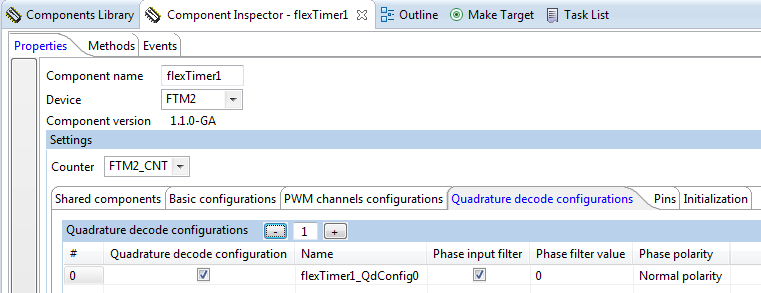

I started by using the fsl_ftm component with the following settings:
With these settings, FTM2_CNT is always 0.

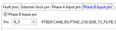

I have confirmed that the encoder works because I have my scope hooked up to PTB18 and PTB19 and can see the signals there.
I then found another post here on the forum that outlined the bare metal configuration.  So I changed my task code to configure FTM2 (perhaps it can't be done in a task?), and the results are the same.  Here is the code I used.  Note that I only modified registers where the already-set value by PEx looked reasonable.

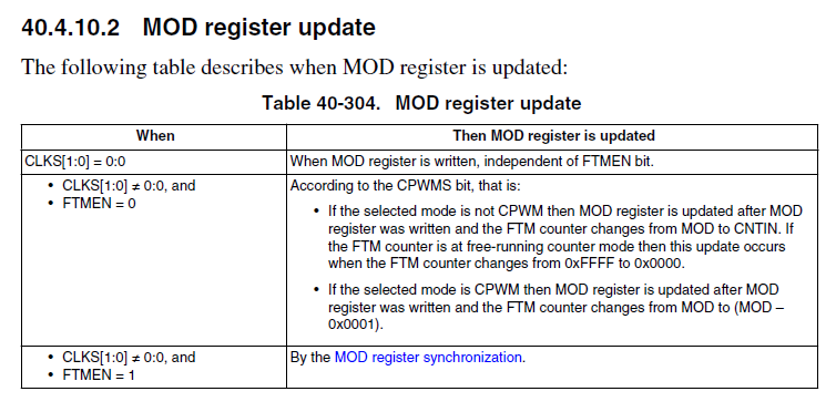

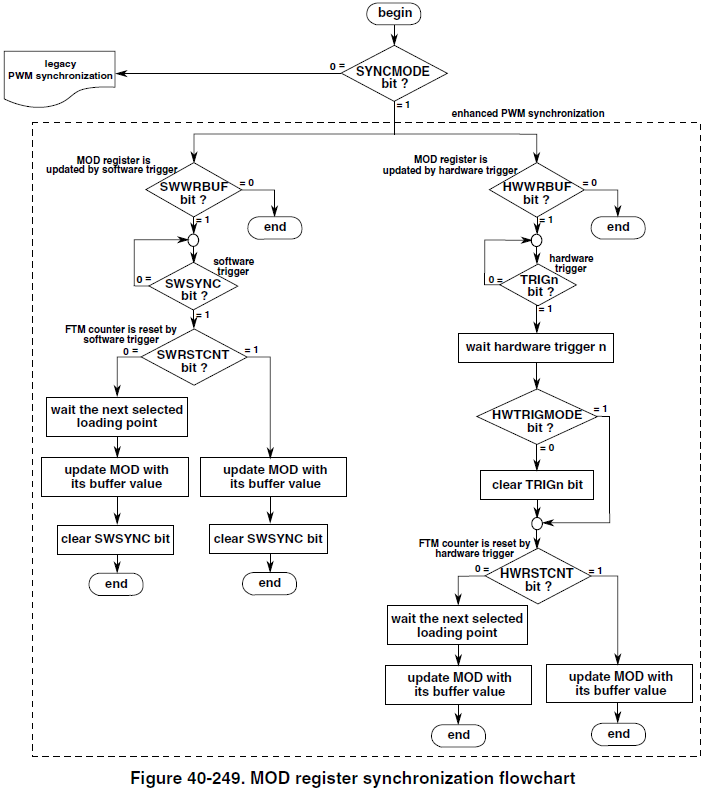

I would check out this (concerning the MOD register):
Writes to it are saved to an intermediate register and only transferred to the MOD register when an update trigger becomes true.

Before I left the office, I read that MOD updates depend upon CLKS, so I next will check into the MCG_C1 register to see what the value is at the time I try to update.  That will determine the method in which I update MOD.  There is a nice large flowchart that explains it.  Sure is a lot more complicated than I would have expected.  :smileyhappy:
8,857件の閲覧回数
dave408
Senior Contributor II
The interesting thing here is that I just checked CLKS[1:0] and it's 0.  According to the following table, doesn't that then mean that FTM2_MOD should update as soon as I write it?

Another thing to look at is the compatibiity setting in the FlexTimer. The default is to work in backward compatibility mode - with TPM (which is a sub-set of FlexTimer) and the extended functions are only operational when this compatibility mode is disabled (or the advanced mode enabled).

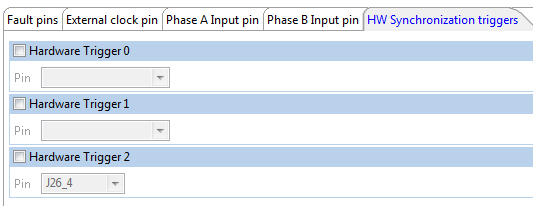

ftm2_synconf    uint32_t    0x1fb4    (need to read up on this, this indicates that hardware triggers are used for some reason, but I had those checkboxes unchecked in PEx)
syncmode    _Bool    0x1
mcg_c1    uint8_t    0x6    (FLL uses slow internal reference clock, MCGIRCLK active)
ftm2_mod    uint32_t    0x0    (this is what I *think* needs to be set to a non-zero value for ftm2_cnt to increment)
