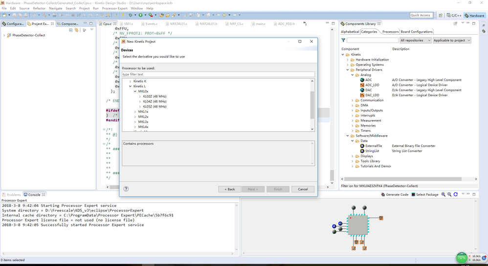

Recently I am developing a project, and I used MKL03Z32VFK4 MCU. I was planning to using Kinetis Design Studio to develop. But I can't find this MCU type, I can find MKL02, MKL04, MKL05,but MKL03, I would like to konw why? And there are any solutions I can use? The version of Kinetis Design Studio is v3.2.0.TIM截图20180308104733.png

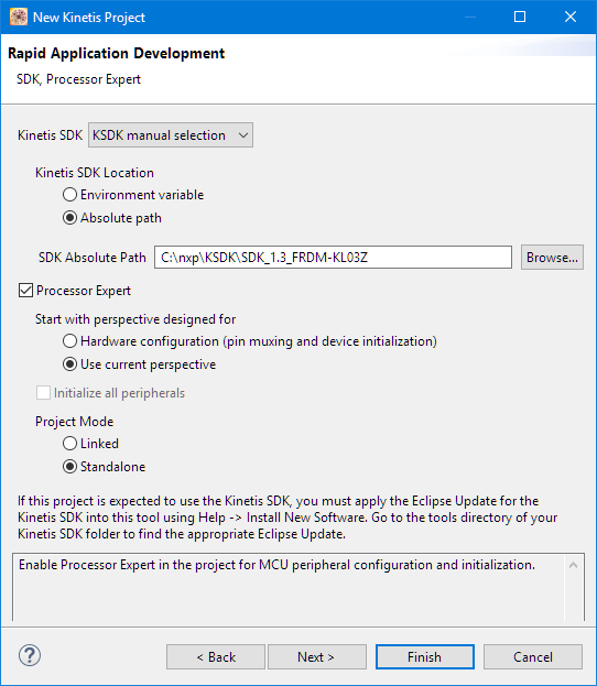

The KL03Z is supported and listed if you install the SDK for it:
Then you have Processor Expert supported (SDK v1.3) too:
See How to use Kinetis Design Studio!! | MCU on Eclipse
I hope this helps,
Erich

Thank you Erich, your answer helped me solve the problem.
Best wishes!
