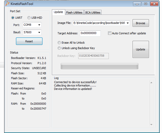

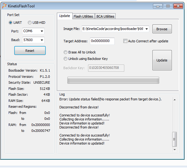

kerryzhou
Hi rohit chudasama,
    Of course you can!
    Because MKE18F512XXXXX already have the ROM bootloader,
You can use PTC7,PTC6.
Then please download our KBOOT2.0 from this link:
https://www.nxp.com/webapp/Download?colCode=NXP_KINETIS_BOOTLOADER_2_0_0&appType=license&Parent_node...
Use KinetisFlashTool in folder:NXP_Kinetis_Bootloader_2_0_0\bin\Tools\KinetisFlashTool\win
Take TWR-KE18F as an example, after you click connect, you will find it connected successfully.
You can find, I can download the KE18F code with UART successfully.
Wish it helps you!
If you still have question, please let me know!
Kerry

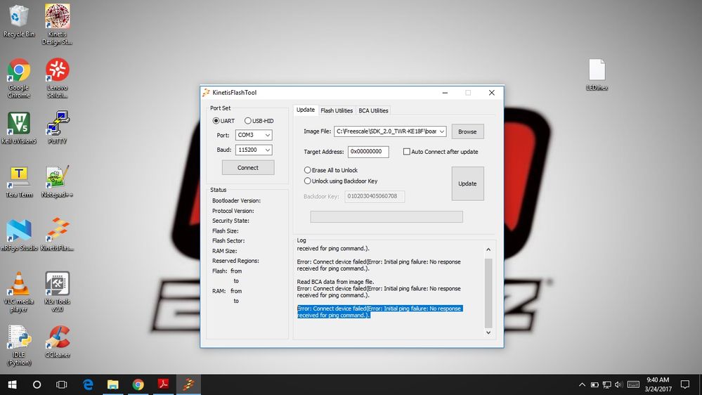

rohitchudasama

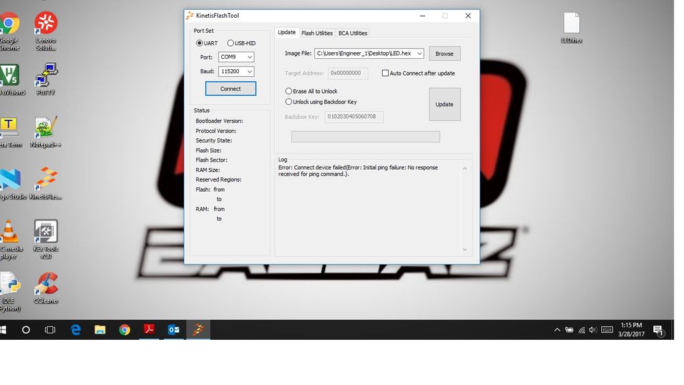

I unable to find Bootloader for MKE18F512VLL16.
So i am getting an Error like "Error: Connect device failed(Error: Initial ping failure: No response received for ping command."

rohitchudasama
I am using TWR-KE18F board. I am trying this on UART_0 (default) and UART_1 (pin : 55,56,57,58).
I am getting the same error on both.my board is connected on COM3.

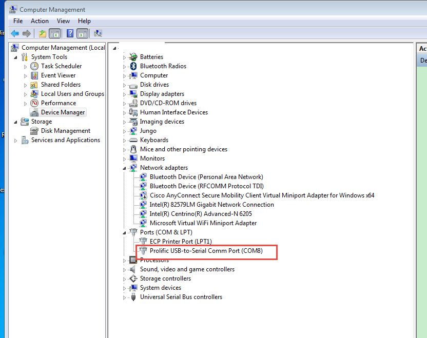

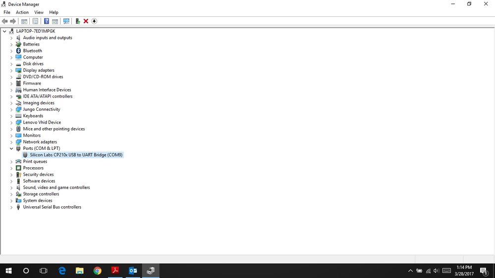

kerryzhou
Hi Rohit chudasama,
   What the tool you connect to COM3?
  Please also post your device manager.
Kerry

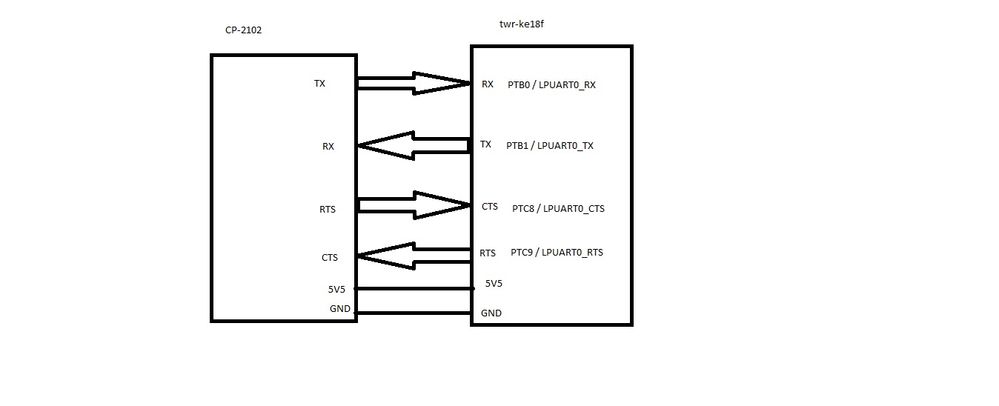

rohitchudasama
I am still getting same error.
I connect PC_RX to PTB1/LPUART0_TX and PC_TX to PTB0/LPUART0_RX. My connection block diagram is below.
I am using CP-2102 from silicon lab to connect TWR-KE18F to my PC. AND its connected on COM9.
I tried by connecting RTS and CTS too. But still result is same.
Even i tried with different board rate. And by pressing SW2 and RESET together and by releasing RESET  and than SW2.
Thanks....

kerryzhou
Hi rohit,
   You said you are using TWR-KE18F,  TWR-KE18F board already have the on board debugger and the virtual com port.
   Why I can't find the on board virtual com port on your side?
   What the on board debugger you are using? JLINK, CMISIS DAP or opensda?
   I think you need to make the on board com port work at first, then use the on board com port directly.
Kerry

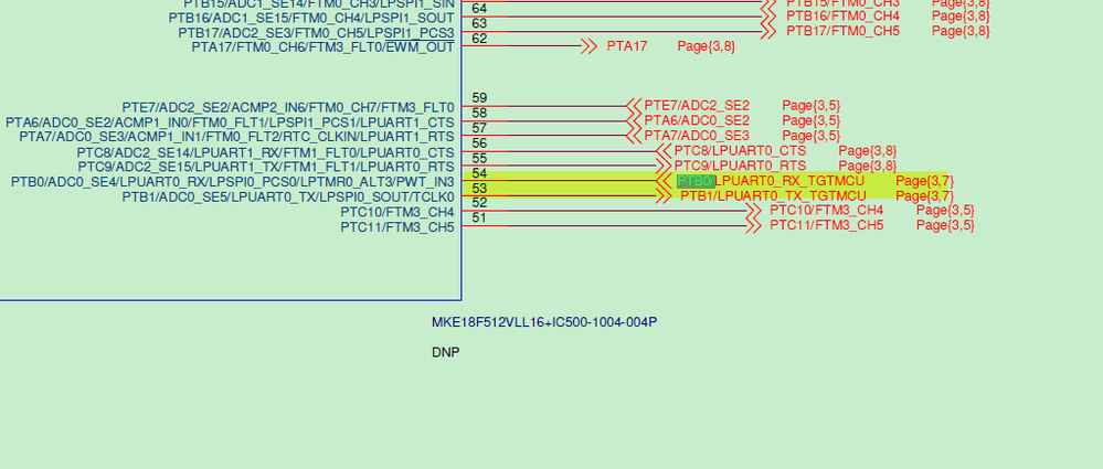

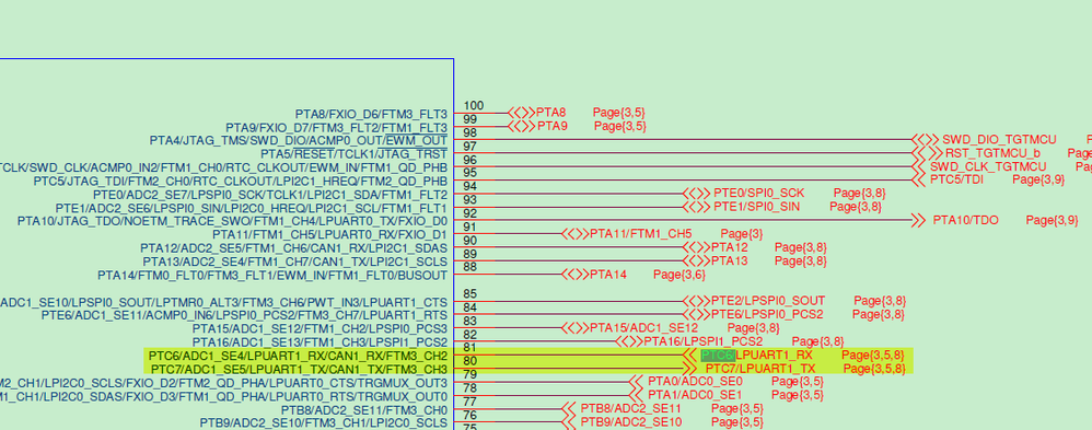

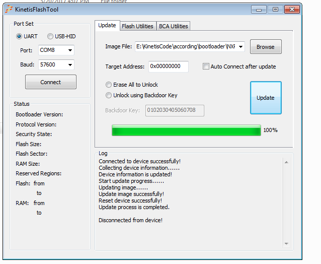

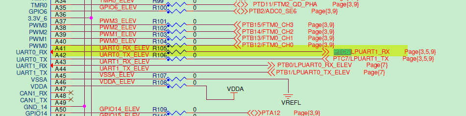

kerryzhou
Hi Rohit chudasama,
     You said:UART_0 (default) and UART_1 (pin : 55,56,57,58).
     This is not correct, did you check the TWR-KE18F schematic?
     I think you connect to the wrong pin.
  1.PTB0, PTB1, it is connect to  the on board virtual com port.
2. PTC7, PTC6

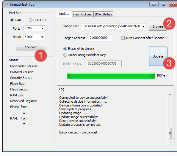

In the post reply, I already give you the result which is based on the PTB0, PTB1.
Now, I give you my test result for PTC7, PTC6. You can connect the tower to the tower elevator board.
A41,A42.
But you need to find a TTL to USB tool, then the PC RX connect to PTC7, PC TX connect to PTC6.
Before you connect the kinetisFlashTool, please press the on board RESET button, and SW2 at the same time, then release the RESET button at first, then release the SW2 at last, take care this is very important.
The following is my test result:
Wish it helps you!
