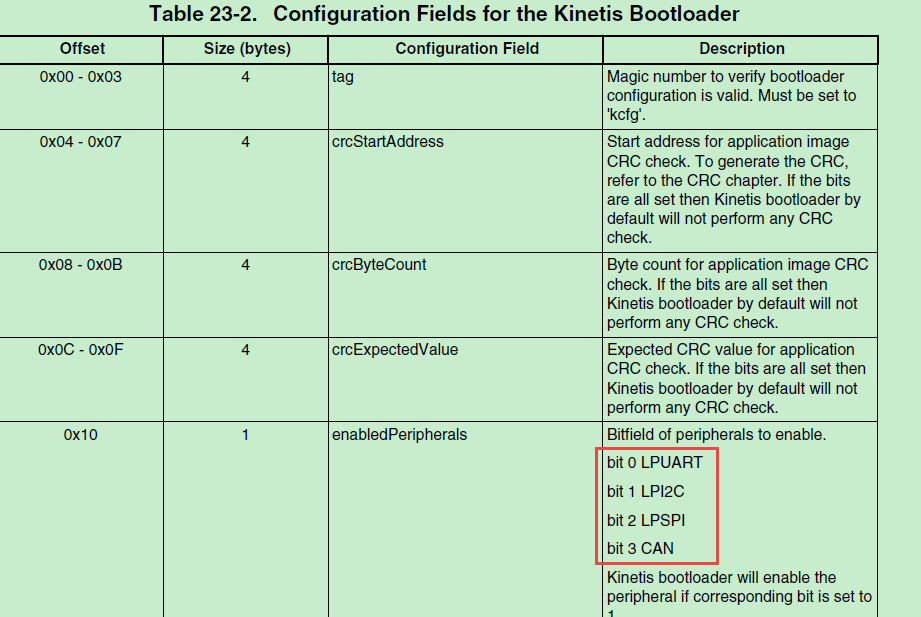

How to start FFU (Field Firmware Update ) on MKE18F512VLL16 ???
Can i do that with USB and ROM BOOT-LOADER ???
What is the Host Application or Software for FFU ???
Thanks....
1,183 Views
kerryzhou
Hi rohit chudasama,
   From the KE18F reference manual, you can find this chip doesn't have the USB ROM bootloader:
Wish it helps you!
Kerry
