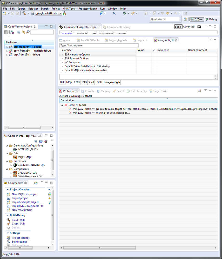

Hi there,
Just wanted to get running an MQX example running on my new FRDM-K64F. But it doesn't matter which example project I try to get running, after drag and droping the .wsd file into the project window and compiling the project, many errors occur. Consecuently I cleaned all and the following error remained:
"mingw32-make: *** No rule to make target `C:/Freescale/Freescale_MQX_4_2/lib/frdmk64f.cw10gcc/debug/psp/psp.a', needed by `gpio_frdmk64f.elf'. Stop."
I'm using
- Windows 7
- CodeWarrior 10.6
- MQX 4.2
- example: hello_frdmk64f
Anyone who could tell me what I'm doing wrong? This problem didn't occur on the project twrk60d100m!
Best regards, Nik

Do you mean compiling bsp and psp? Well according to the MQX_Gettng_Started.pdf Section 2.1 NOTE:
   "...Prior to MQX RTOS 4.0, the PSP and BSP libraries had to be built before the other libraries. This is no longer required..."
it's no longer necessary to build the libraries first!?
I also tried to delet the complete folder "frdmk64f.cw10gcc" in C:\Freescale\Freescale_MQX_4_2\lib\... and recompiled it. After compiling the first time I get this
and after I compile a second time i get this
So I still don't know how to get rid of that problem!? :-(

Hi Daniel,
Btw, thank you for your responses.
Unfortunately it doesn't matter which I compile first, it always ends up in the same errors. Trying the same with the TWR-K60D100M works properly (well more or less: I had to change in the "Debug Configurations - Debugger - OS Awareness - Target OS:"-Settings from "None" (default) to MQX OS for Cortex).
Below there you can see the console output:
