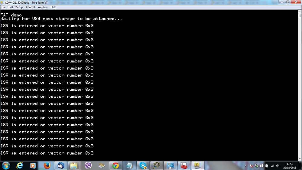

MAPC
Senior Contributor I
Hello, Dear Yasuhiko
Thanks for the tips.
I really forgot to mount this jumper on FRDM-K20D50M. But I just did it now and tried to run again. After mounting and shortening it I got the following screen:
Have you ever experienced something like that?

yasuhikokoumoto
Hello Paul,
it seems to occur the hard fault by some reasons.
Honestly speaking I have only an experience which I executes the simple USB sample codes which are included in the freescale package.
The hard fauld would hapen by several reason.
A USB sample code is too complicated to analyze if errors had occurred.
I'm very sorry but I cannot help you.
I would expect that experts will help you.
Yasuhiko Koumoto.

MAPC
Dear Yasuhiko,
I just ran the msd_mfs_generic demo code on a FRDM-K20D50M kit, as it is. So, I really can't understand this failure.
I'm trying to find the cause of this Hard Fault interrupt by debugging the code. But it is not easy!

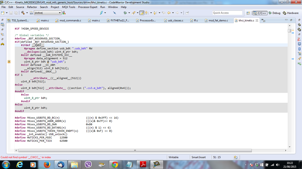

Kan_Li
Hi Marco Coelho,
This case reminds me some bug I reported before, please kindly refer to [USB stack ver 4.1.1] a code issue in msd_mfs_generic host demo  for details.

MAPC
Dear Kan_Li
Thanks for the response.
Strange! This part appears in grey to me! What does this mean? And how can I fix it?
It seems like "__CWCC__" macro is not defined in the demo. Should I force it and just touch to see it?

Kan_Li
Hi Marco Coelho,
The __CWCC__ is a predefined macro in CW IDE, and it is integrated in the compiler , and active during the compiling, so it might be inconvenient to read the code, but actually there is no need to define it in a project.

MAPC
Hi, Kan_Li
I still don't understand why this __CWCC__ is not automatically set in the demo. Do you have an idea of what might be causing this issue and how can I fix it?
