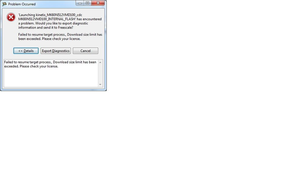

I'm getting a code size limitation warning when I try and debug the CDC example from the USB stack V4.11. This is on segger Jlink or OSBDM debug options.
Map file output:
# Memory map:
  v_addr        p_addr   size          name
  00000000 00000000 000001E0 .interrupts m_interrupts
  00000800 00000800 00004920 .app_text  m_text
  1FFF0000 00005120 000006F0 .app_data  m_data
  1FFF06F0 1FFF06F0 00000BD0 .bss       m_data
  1FFF12C0 00005810 00000018 .romp      m_data
  00000400 00000400 00000000 .cfmprotect m_cfmprotrom
So if you add the sizes, it comes out at 24024Bytes decimal. K series has 128KB limitation according to this page.
I'm running CW10.4se on windows 7 pro x64. The K70 example worked fine over OSBDM (jlink wouldn't work for some reason) and when I hit debug, it says it can't continue, and to check my licence.
Anybody got any suggestions???

ok, I see. So this is not a warning, but an error. That's why I was not sure what you are seeing.
Maybe it is this problem I had too:
Please Check Your License | MCU on Eclipse
I hope this helps you too.
Erich

Here's the warning, diagnostic info is attached.
As said above, I can compile/run/debug the processor expert version, but not the baremetal version.... I'm running 10.4SE but have had previous versions of CW on this machine. (10.2, 10.3beta & 10.3 iirc)
Erich
4,490 Views
Frost
Hi Erich,
  thanks for your help. It was the exceptions box that was checked - code size downloaded was 11100Bytes after a clean+build.

Yeah, so this saved you some code size too :-)

Well that's right. I was interested in how much difference it was, as I'm playing around in this area for possible projects at work; Nice to know what another CW checkbox does though! :smileyhappy:
4,490 Views
Frost
I tried the Processor Expert CDC example. It worked, BUT I had to re-configure it as follows:
When trying to debug, it will first say "invalid memory configuration file". To fix this, go into the debug settings, and re-point the target .mem file to the .mem file in your project. It uses the USB Audio example .mem file by default. If this is not in your workspace because you haven't opened the audio example, you need to re-point it.
As above, the kinetis init .tcl file needs to be re-pointed from the same place as well.Then it debugged using osbdm debugger.
The project downloads 14500Bytes, as a size indication. Still can't find why I'm having the limitation warning above.
