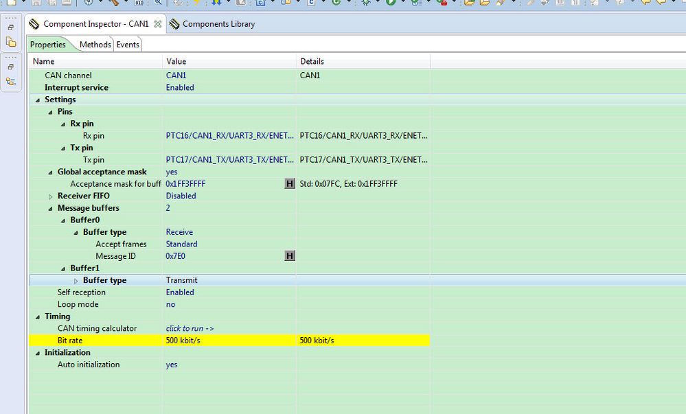

     I already help you create a K70 KDS CAN_LDD project, you can refer to my project, the CAN_LDD configuration is like following:

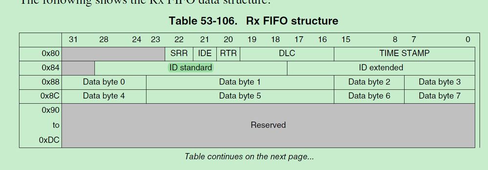

Because you want to receive the standard ID:0x7E0,0x7E1,0x7E2
the standard ID is 11bit, it is:
0x7e0: 11111100000
0x7e1: 11111100001
0x7e2: 11111100010
Then, you can use the acceptance mask to care all the higher 9 bit ID, and don't care the lower 2bit.
so you can configure the acceptance mask for buff(register CAN1_RXMGMASK) = 0x1ff3ffff, you can combine the Rx FIFO structure in RM to understand it:
Actually, if you don't care the lower 2 bit of the standard ID, you can receive just 0x7E0,0x7E1,0x7E2, 0x7e3, then all other standard ID won't be received.

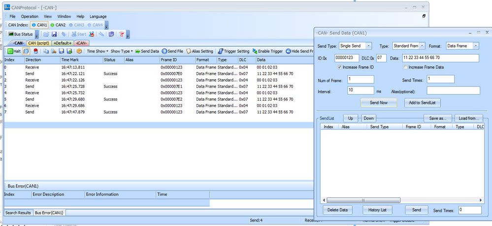

I already test my project on my TWR-K70F120M, the test result is like following:
You will find 0x7E0,0x7E1,0x7E2 can be received by the K70, but the 0X123 will be reject.

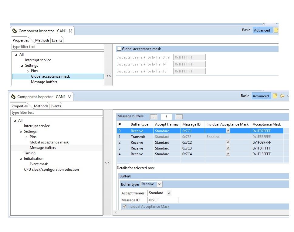

Mode : 1
Golbal Acceptance Mask, Buffer 0...N = ok
Mode :2
Invidual Accptance Mask = not run all ID
see:
my_function_calc_mask()
uint mask   = 0x7C4;
uint xor      = 0x1FFFFFFF;
uint accep = 0x1FFFFFF; // 0001-1111-1111-1100-0000-0000-0000-0000
            mask  = mask << 18;
            mask |= 0x3FFFF;  < ---Acceptance mask ividual
note:
Buffer:0 0x7C1 = ok
Buffer:2 0x7C2 =  not accepted
Buffer:3 0x7C3 = ok
Buffer:4 0x7C4 = not accepted
buffer_zero defined all masks.
thanks,
Carlos.

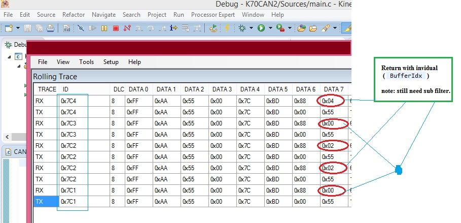

CCandido
Contributor V
Hi Zhou,
thank you for your help.
Solved Invidual acceptance mask filter.
see:
calc_id_mask
uint mask   = your_id ;   // 0001-1111-1111-1100-0000-0000-0000-0000
   mask  = mask << 18;
   mask |= 0x3FFFF;  < ---Acceptance mask invidual
void CAN1_OnFullRxBuffer(LDD_TUserData *UserDataPtr, LDD_CAN_TMBIndex BufferIdx)
simple
    switch(  BufferIdx){ read buffer_x }
Carlos.
