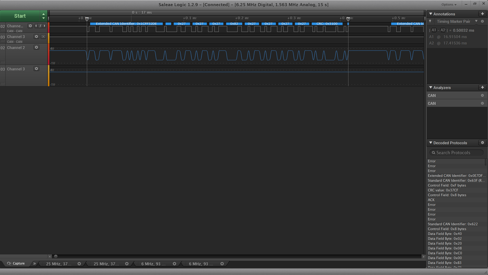

Hey, I am working on a project involving a K64F board with a can transceiver attached on a breadboard.  If i hook up my logic analyzer to the RX line, i can see traffic; however when i wire the transceiver into the k64f, the interrupts created by processor expert using PTB19 for Rx and PTB18 for Tx never seem to fire.  as a result, the board seems to not be getting any of the information. Any help would be appreciated, attached is a picture of my processor expert configuration as well as the project

So i've spent most of the morning attempting to get a good test done.  The TX line from the k64f actually seems to produce garbage CAN information.  Attached is a picture of what I see on my logic analyzer, showing the incorrect extended frame data, as well as "ERROR" for the data bytes.  It is odd that the RX line from the transceiver is picking up the data from the TX line.  I am unsure as to what is going on.  It is of note that if i plug the line into the active CAN line, I do see the normal traffic from the controller, however it is overlapped in some places with this garbage data, as though it is failing to write, and then echoing its TX over the RX
9,974 Views
egoodii
Senior Contributor III
CAN is inherently half-duplex, so 'self reception' is actually 'good proof' that your TX gets to a terminated wire-pair and your RX picks it up (unless your transceiver is in some kind of local-loopback mode?).  BUT I would LIKE to see just a 'little extra' stuff on RX at the 'end' to be the ACK or NAK from other bus participants.  I am a little concerned about your packet-length though -- I always figure CAN as 'about' 120bits, including 64data, 40-some for header&CRC, plus necessary 'bit stuffing' based on content -- but still at 4us/bit that seems like it should come to about 0.5ms  --  your 0.62 just 'seems long'.  Can you confirm your clock-source/divider?
