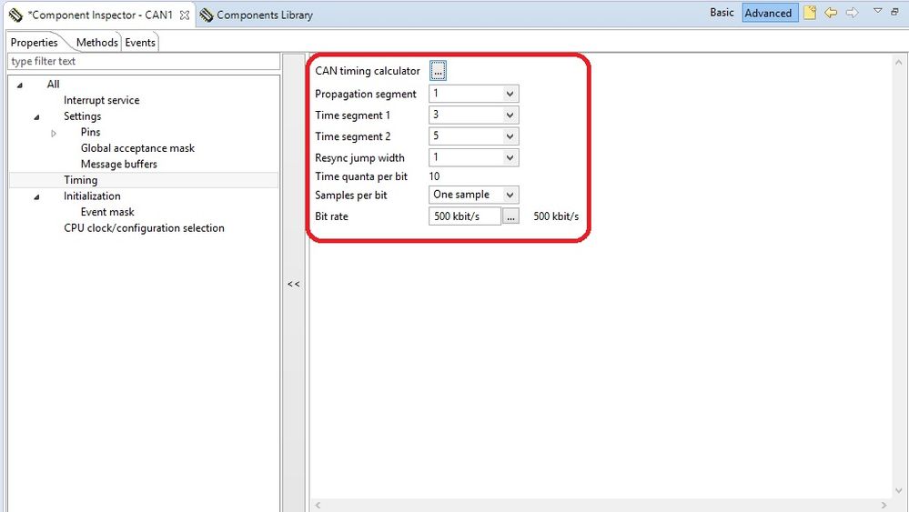

how to calculate the bit time parameters can the network?

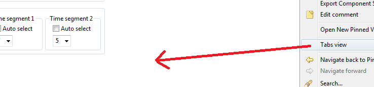

seems that CAN timing calculator does not work properly in new Tabs view. When you swithc to old inspector you should get correct functionality.
#1 Switch to old inspector
#2 Run calculator
best regards
Vojtech Filip

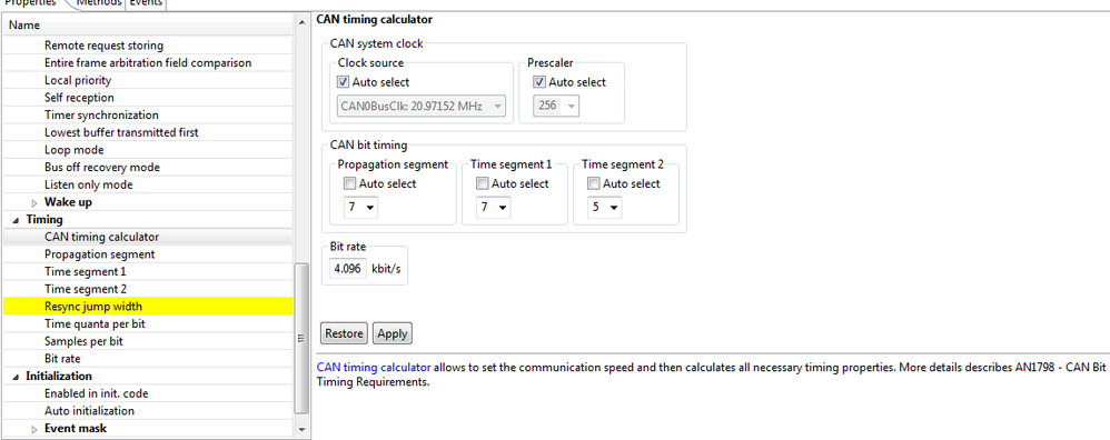

There is an application note about CAN bit timing, please check here for the detailed info.
I checked Processor Expert tool provides Auto Select CAN bit timing parameters, customer just need to set the CAN baud rate.
Wish it helps.
