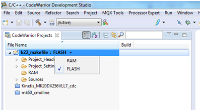

  1. Create and new project “k22_makefile” in CW v10.6, you will see there are two build configurations: RAM & FLASH

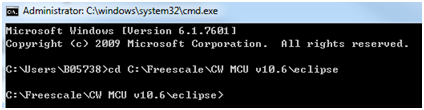

  2. Launch “cmd prompt” in Windows and go to “eclipse” folder of CW installation
  3. Now, you can generate the makefile for configuration FLASH by executing the below command
    ecd.exe –generateMakefiles –project “C:\workspace_cmd\k22_makefile” –config FLASH

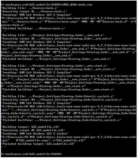

5. Go to the configuration folder “FLASH” where the project’s makefiles are located and run the follow commands to build the project.
%MCU_BIN%\make.exe
