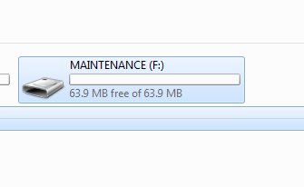

When I received the board it rebooted every 30 seconds. After finding out that the current bootloader was outdated and cooporating with Windows 10 I decided to update it. Following these steps kept the board in bootloader when I chose "DAPLink rev0244 OpenSDA v2.2 Bootloader" and showing frdm-k64f when I chose "DAPLink rev0244", with the latter one it showed 63.9mb flash on Windows 10, but everything was working normal. This didn't look right to me so I kept digging to find what was wrong so I found this and followed these steps. The board booted up with the name "DAPLINK" as descriped, but still 63.9mb flash available.
Is this normal?

   After enter the bootloader(press the reset button and plug the usb cable), the DAPlink disc name is "MAINTENANCE"
I am also 63.9MB, it is correct, it is just in the BOOTLOADER mode.
If you use the JLINK firmware, you will find the board is a device named as "FRDM-K64FJ"
 Now, you can use the JLINK to download the code to the board.
 If you enter the bootloader, the device name is the same as me, it means you already use the new bootloader firmware.

Yes I've noticed. I the bootloader was succesfully updated without an external debugger. The incorrect size was the thing that was worrying me. Knowing this is the same with others I can continue knowing my issues don't originate in this.
