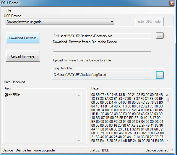

mayursavaj
Hi Kerry Zhou,
I created .bin file from KDS and tried to update firmware using DFU Demo tools which i am using for CW (device have CW bootloader).
Firmware updation starts after 30 seconds it throwing error.

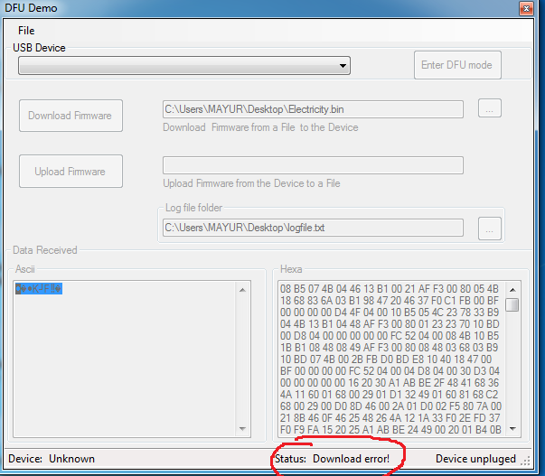

mayursavaj
Hi Kerry,
Sorry for late reply. I have tried for simple program its giving same error.
Error Screen
Mayur Savaj

kerryzhou
Hi Mayur Savaj,
   Could you tell me where you get this DFU demo software? Do you design it by yourself?
Kerry
6,446 Views
mayursavaj
Hi Kerry,
DFU Demo is a firmware updation software provided by freescale.
Mayur Savaj
6,446 Views
kerryzhou
Hi Mayur Savaj,
Thank you for your updated information, this tool is provided in AN4770SW, that is really very old.
Could you tell me what the kinetis chip part number you are using? Do you use the bootloader also from the AN4770? If yes, please tell me which bootloader you are using? If you use the CW project, do you can make it work with DFU demo?
Kerry
