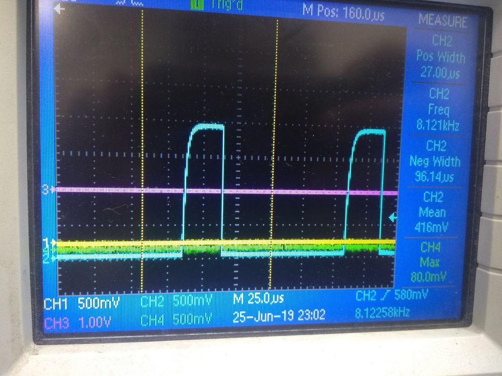

Hello Everyone,
I am bringing up my board which uses mkv46f128vll16. When I am programming my code runs correctly but after Power On device remains in reset. Below is the probed waveform of RESET Pin.
I also Probed RESET when FLASH is Erased which seems to be fine.
Debugger: Multilink Universal
IDE: MCUXPRESSO

Hi Shiv Aishwarya,
Please refer: How To Sucessfully Program a Custom made Kinetis Microcontroller Board.
Since you are using the MCUXpresso IDE, step8 be replaced by resurrect locked Kinetis device in GUI Flash Tool.
