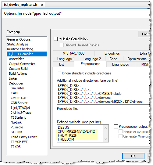

Hello
I have a question
I am working with IAR, it generates an error, where I can define my microcontroller MK22FN128VLL10 and how to do it, I thank you very much

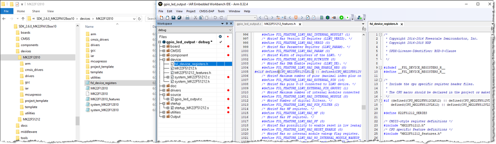

Please find the MK22F12810 related files in MCUXPresso SDK folder(...\SDK_2.6.0_MK22FN128xxx10\devices\MK22F12810)
CPU_MK22FN128VLL10 should define in Defined symbols.
