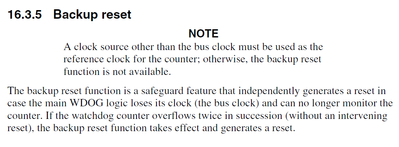

Hi.
Does the WDT reset stand in the status register when the backup reset function works and is reset? SIM_SRSID [WDOG]
thank you.
jun.
2,233 Views
nxf58904
SIM_SRSID [WDOG] will stand when system reset by backup reset.
