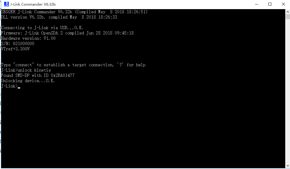

     Here is not a phone number of NXP. So, today, I retry to input the "unlock kinetis" command with the J-LINK commander tool. It seems to be working and it writes that "Found SWD-DP with ID 0x2BA01477        Unlocking device...O.K."
    But when I turn buck to  bootloader mode, it is also cannot dowload program.
   After the command--"unlock kinetis"  works out ,  what should I do.
  Looking for your help.Have a good day.

mjbcswitzerland
Specialist V
I don't think that the un-secure command is what you need (this won't necessarily change the loaded code from disabling the pins) - you need the mass erase command to restart with a "fresh" chip.
