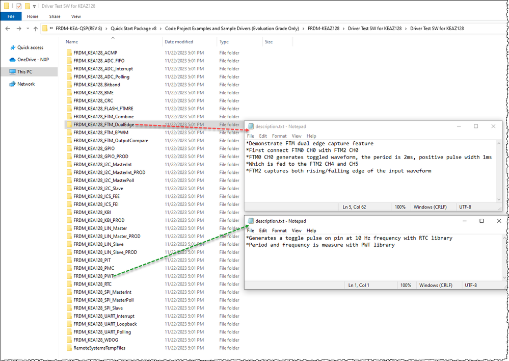

I'm using keaz128.I want to use ftm0 of keaz128 to capture PWM, calculate the duty cycle and frequency of PWM, is there a corresponding routine to provide.

Hi shunyizhang,
Please download the FRDM-KEA Quick start package (REV 8 ) from FRDM-KEAZ128: KEA Freedom Evaluation Board.
Please open these examples with S32 Design Studio for Arm 2018.R1 – Windows/Linux(REV 2018-R1) .
Then you will find FRDM_KEA128_FTM_DualEdge and FRDM_KEA128_PWT examples.
FRDM_KEA128_FTM_DualEdge FRDM_KEA128_PWT.pngFRDM_KEA128_FTM_DualEdge FRDM_KEA128_PWT.png
