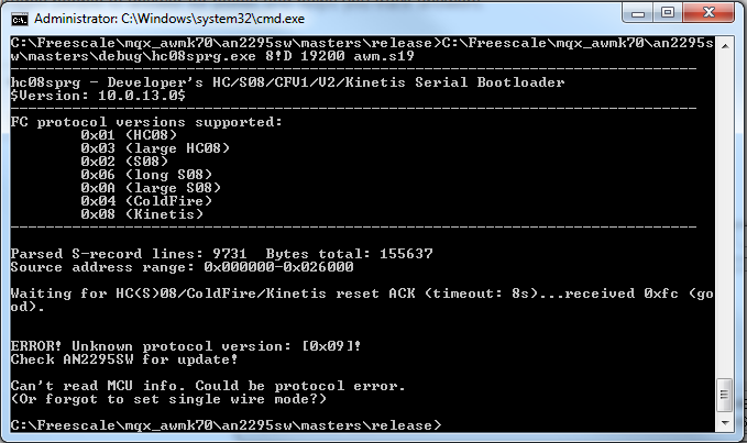

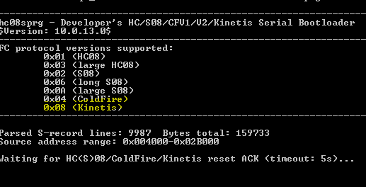

I'm having issues implementing AN2295 over with K70.  One of them is apparently the hc08sprg.exe does not talk protocol 9 which is defined in a target?
When i hardcode it to use protocol 8 I get same a message saying "Can't read MCU info. Could be protocol error" If I open a terminal and type in "I" I get the following:
so the mcu is talking and available. Is there a something I'm missing in the configuration of the target?
Yes, I'm using the latest app source code I was able to find, stamped with Date Modified 10/12/2012

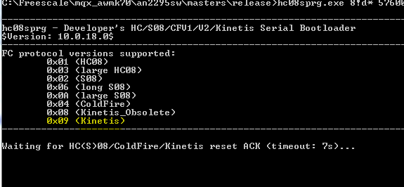

Hi Andrey,
you are using the master application hcs08sprg version 10.0.13.0 as I see. I send you the latest one (10.0.18.0) in the attachment. Could you try it and let me know.

pavel_krenek
Hi Andrey,
I send the latest AN2295 software package in the attachment. Could you try it and let me know if there is any difference.
Pavel

Andrey
Pavel,
It looks like the problem is not with the src (target) files, but with the hcs08sprg which does not recognize the new protocol for kinetis (protocol 9). I'm currently using protocol 8, and limited to 512k or so.

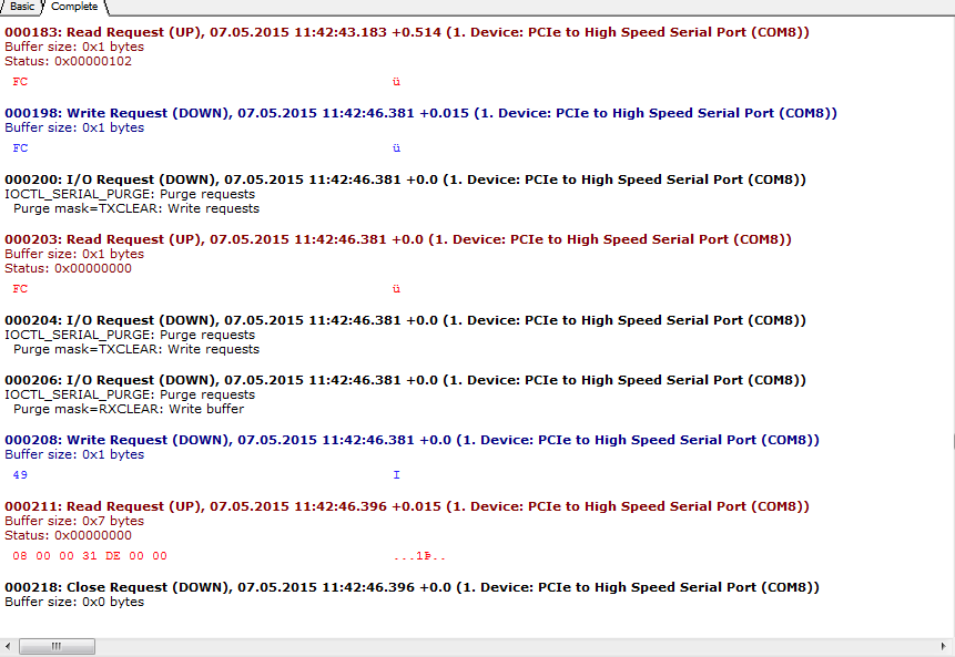

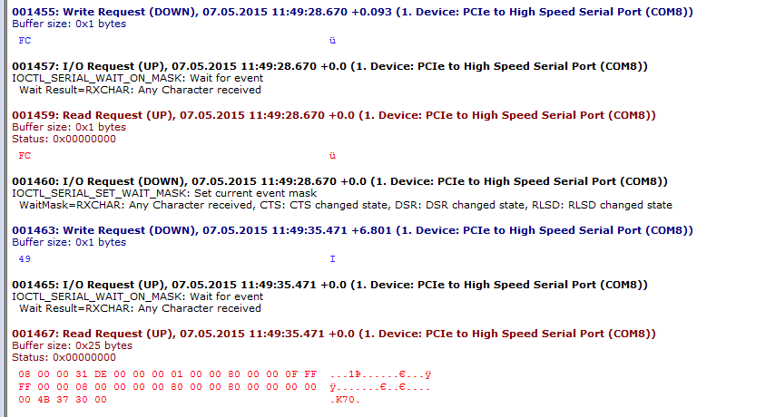

Andrey
Pavel,
I have set the SHORT TRIM settings and it still hangs.
It looks like the hc08sprog is not waiting for the complete packet. I've tried at different baud rates (9600 and 57600)
Notice that the Close Request is done at the same instance as the Read Request
manual communication:
all the data received.
Perhaps it's a timing issue of some sort.
