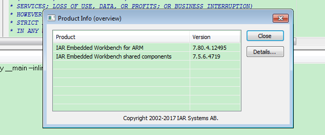

4,923件の閲覧回数
kerryzhou
Hi DHRUV A,
   I have use the IAR 7.80 to open it, it builds without errors.
I also tried the IAR 8.22 version, also no problem
So, you need to update your IAR version.
Wish it helps you!

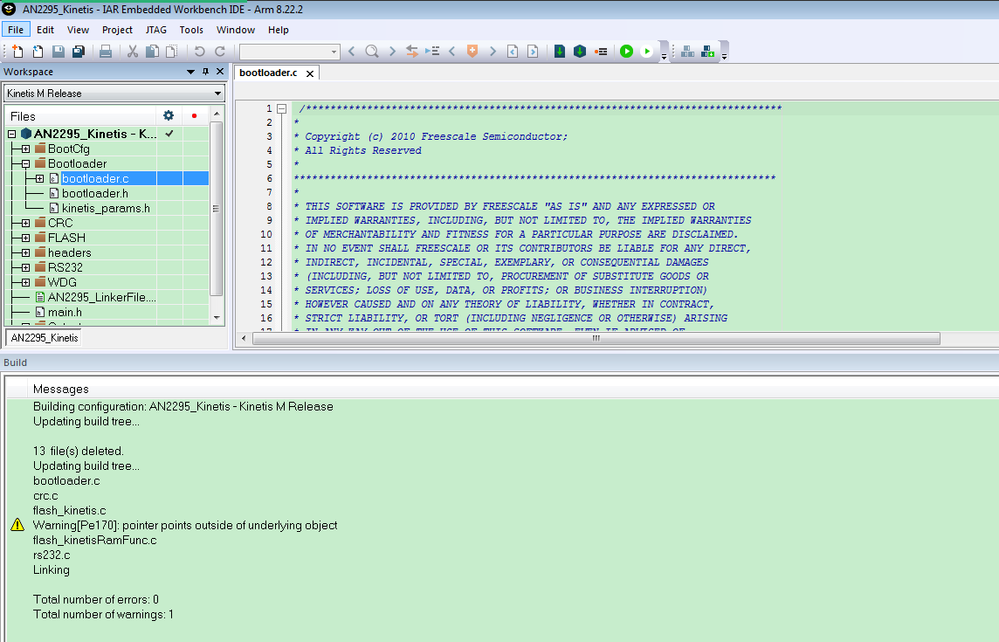

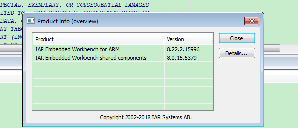

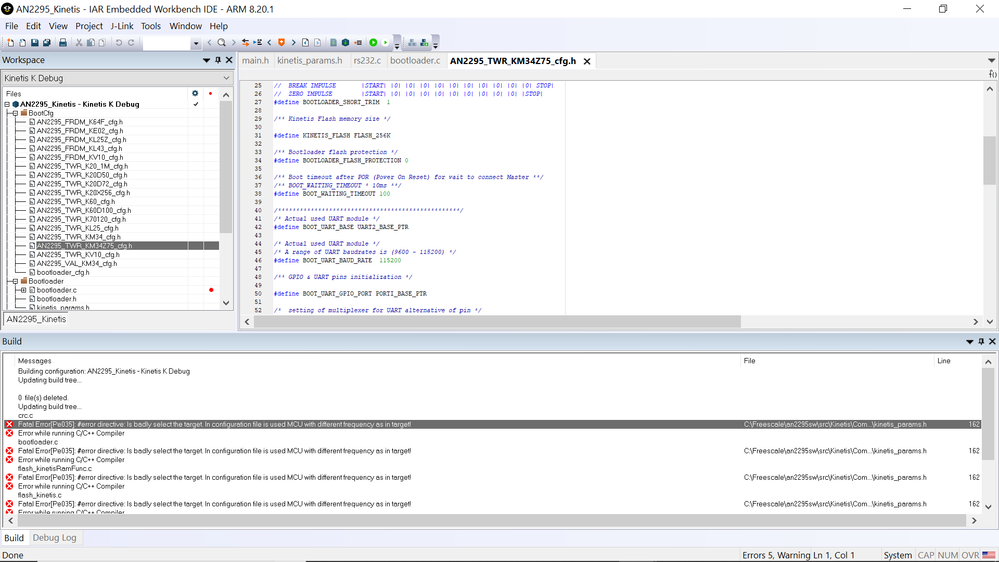

dhruvonline
Hi Kerry,
Thanks for the support.
I have tried with IAR 8.21. Now we are able to open the project.
But while compiling, it is giving below error. Please suggest..
Thanks&Regds,
Dhruv
4,923件の閲覧回数

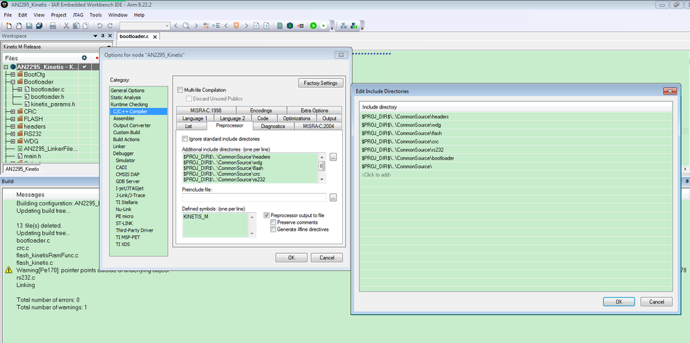

kerryzhou
Hi DHRUV A,
  Please check the options on your side:
Do you have the include directories and symbols?
Kerry
