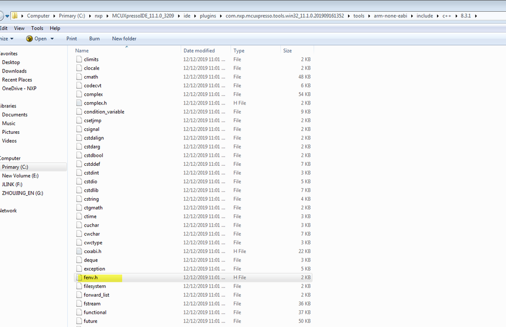

 KDS is the old IDE, which is not updated now.
  Now, we mainly use the MCUXpresso IDE, which is used to replace the KDS.
  You can download it from this link: www.nxp.com/mcuxpresso
  I have checked, this IDE contains the fenv.h.

That's under the C++ headers.  What about C?  Using MCUXpresso and any of the C standards, I still get include file not found.  Those same C++ headers are available in KDS too.

  I search it, and didn't find the C code in the MCUXPresso IDE.
   Maybe you can find the related files in the website, and add it in your code.
