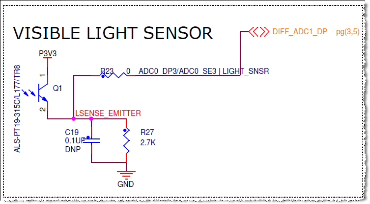

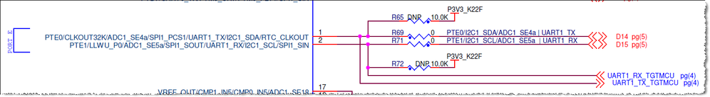

I'm using a FRDM-K22F with two pins configured as ADC inputs using Processor Expert. I've stuck with the default settings (longest conversion time, low-power not checked, high-speed not checked, single-ended mode, sharing not checked).
I'm testing a 5V-output sensor through a (50%) resistor divider which should give a voltage swing between 0-2.5V at the ADC input. While ADC1_SE5a seems fine (readings agree with a multimeter, etc) the ADC0_DP3 input seems to be drawing a significant amount of current, despite being configured in the same way as ADC1_SE5a.
When the sensor is outputting 4.7V, the resistor divider gives about 2.3V through the divider if it's not connected to any ADC inputs. If I wire it to ADC1_SE5a, I still get 2.3V when sampling. If I wire the 2.3V node to ADC0_DP3, it gets pulled down to .9V.
It appears that the resistor divider I'm using creates a sensor output impedance which is too high for the ADC0_DP3 input impedance. Why is ADC1_SE5a not having the same issues?
ADC0_DP3 gives reasonable readings using a low-impedance source (power rails or gnd) so it's not just a conversion/scaling issue. If ADC1 was sampling from more than 1 channel this could be caused by the inrush current when the channel switches but since it's only connected to 1 channel, this probably isn't the explanation.

Hi Alexander,
Please pay attation to the hardware connected to these two pins on FRDM-K22F board.
Robin
