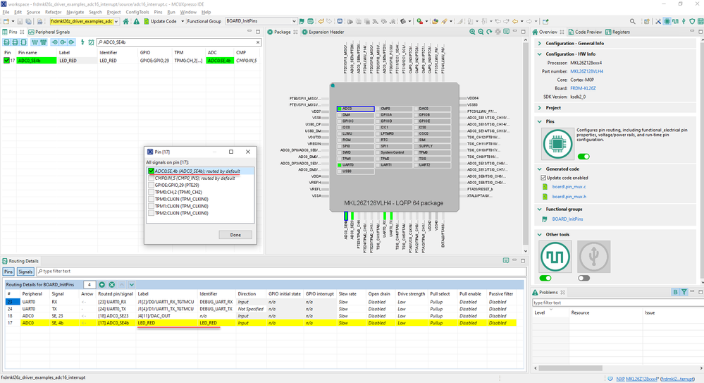

I am using mkl26z256vlh4 in which I am specifically observing pin 29 of port E i.e./ADC0_SE4B, my purpose is to get voltage of this pin and decide further action, but I am not getting stable ADC values. I am using 3.3v Vref and input is 3.3v.
I have configured it as 12bit ADC. I have enabled average mode for 32 samples which is giving me a more stable output than previous but the ADC values reading after averaging is differing than actual voltage of that pc. and one more thing i am using voltage divider with R1=470K   R2=220K.
#define DEMO_ADC16_BASE ADC0
#define DEMO_ADC16_CHANNEL_GROUP 0U
#define DEMO_ADC16_USER_CHANNEL 4U                   /* PTE29, ADC0_SE29_4B */
this is how I have defined ADC channel, is user channel correct for mentioned pin?

Have you test the ADC example(for example frdmkl26z_driver_examples_adc16_interrupt or frdmkl26z_driver_examples_adc16_polling) in MCUXpresso SDK?
Does the default ADC input pin(ADC0_SE23) of the example also get such unstable value?
The ADC0_SE4b on FRDM-KL26Z board is connect to RGB LED, so I am not able to test it at my side.
ADCx_CFG2[MUXSEL] bit selects between ADCx_SEn channels a and b. Refer to MUXSEL description in ADC chapter for details.
Please check the value of ADC0_CFG2[MUXSEL] during debug, make sure MUXSEL=1 ADxxb channels are selected.

omkar_virkar
#if defined(FSL_FEATURE_ADC16_HAS_MUX_SELECT) && FSL_FEATURE_ADC16_HAS_MUX_SELECT
ADC16_SetChannelMuxMode(DEMO_ADC16_BASE, kADC16_ChannelMuxB);
#endif /* FSL_FEATURE_ADC16_HAS_MUX_SELECT */
i was missing this in my program. after including ADC16_SetChannelMuxMode(DEMO_ADC16_BASE, kADC16_ChannelMuxB); ADC VALUES are stable.
thank you!
