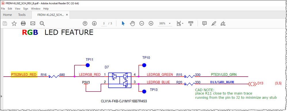

Have you test the ADC example(for example frdmkl26z_driver_examples_adc16_interrupt or frdmkl26z_driver_examples_adc16_polling) in MCUXpresso SDK?
Does the default ADC input pin(ADC0_SE23) of the example also get such unstable value?
The ADC0_SE4b on FRDM-KL26Z board is connect to RGB LED, so I am not able to test it at my side.
ADCx_CFG2[MUXSEL] bit selects between ADCx_SEn channels a and b. Refer to MUXSEL description in ADC chapter for details.
Please check the value of ADC0_CFG2[MUXSEL] during debug, make sure MUXSEL=1 ADxxb channels are selected.

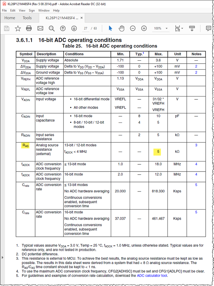

voltage divider with R1=470K   R2=220K
Can you list how the resulting values are unstable?

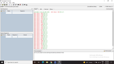

omkar_virkar
for the I/p of 3.3v this are ADC values I am getting whereas, I am getting 1.06 v reading on  DMM

bobpaddock
Senior Contributor III
If you are driving the ADC input from the junction of R1&R2 with those values, that impedance is way to high, cut them down by at least a factor of ten.  Always best to drive ADC with a proper driver Op-Amp.
