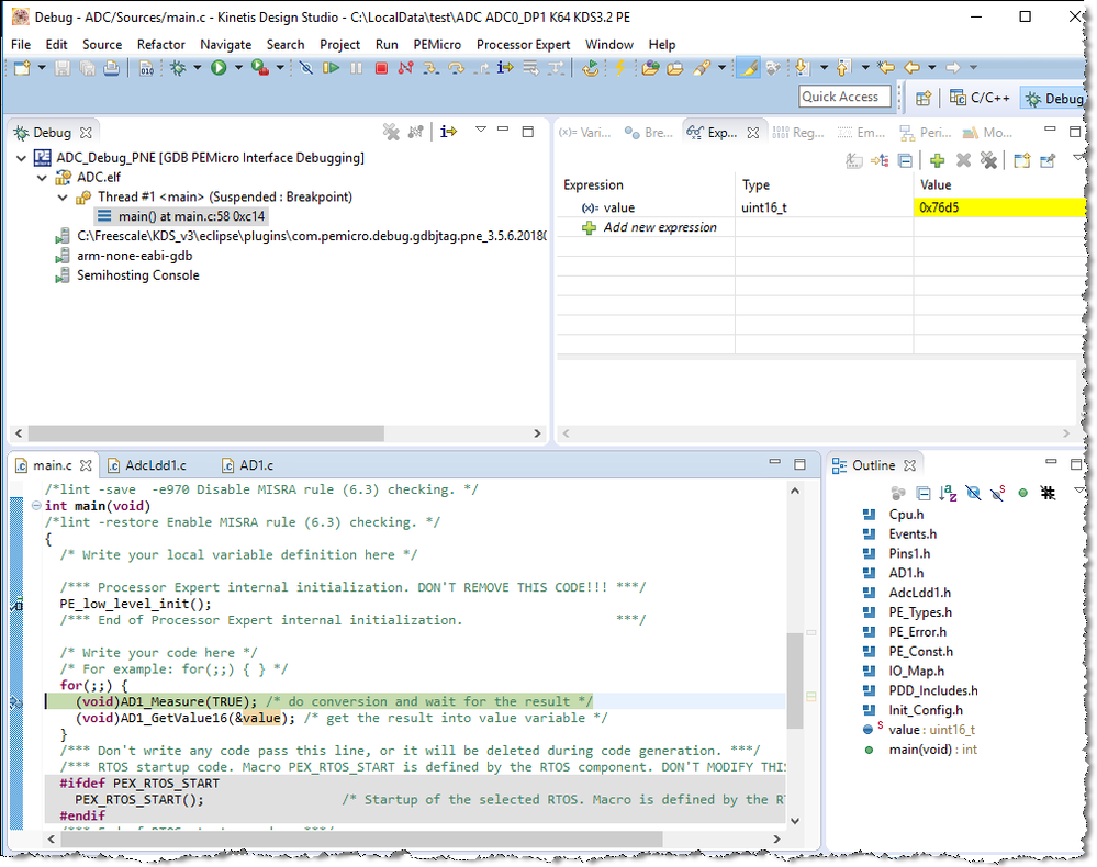

Good morning everybody,
I tried to use an ADC to get data from pins (they are either at 0 (ground) or 3.3v).

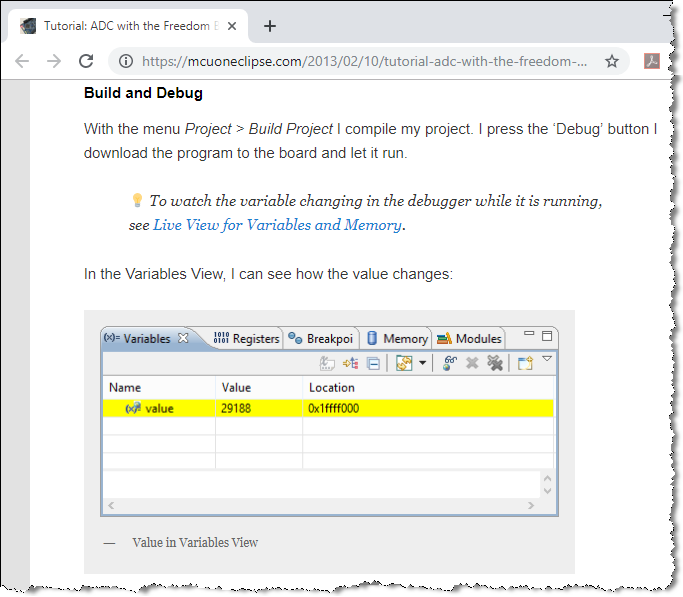

I have used this helpful tutorial : Tutorial: ADC with the Freedom Board | MCU on Eclipse  yet with a break point it get to AD1_GetValue16(&value); but then goes into an infinite loop and value is never updated.
To get started, i am just trying with only one pin, currently my test pin ADC0_DP1 is grounded.
I will join my ADC settings and code to show you what i have done.
Thank you for your support :smileyhappy:

I try to follow that Tutorial using KDS3.2 test on FRDM-K64F board.
In the Variables View, I can see how the value changes:
Would you please let me know the problem that you meet?

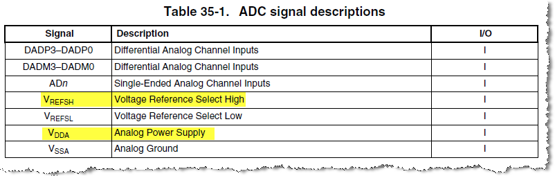

If the value is always 0 or 3.3v, then you may need to check the voltage of VREFSH and VDDA.
