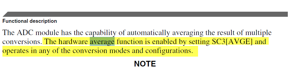

Hello Community,
I have been working with Kinetis MK24FN1M0 microcontroller and performing ADC measurements. According to our requirement, the ADC has to perform measurements every 10µs. For this I have used the FTM timer 2 and configured it to trigger the ADC every 10µs. Then, we wanted to take an average every 32 measurements and generate an ADC Interrupt. To my surprise, the ADC with hardware averaging count of 32 is generating an interrupt every 175 µs . When I trigger and perform ADC measurements every 10µs and 32 ADC measurements should sum up to 320µs. But this is not working. Initially, I thought it was timer which was not working correctly, I disabled the hardware averaging and observed the interval betwen every ADC Interrupt. It is exactly 10µs. But as soon as I enable the Hardware Averaging, and check the interval between the Interrupts it is just 175µs.
I then changed the timer trigger interval to 1 ms, but the hardware averaging ADC interrupt shows up again after 175µs. I don't understand this behaviour.
I have even checked the ADC registers, if I have configured anything wrong but everything seems right with the configuration. I am very disappointed with the result and I would really appreciate if I could get the Hardware averaging working correctly.
Any suggestions in finding a solution to this problem would be of great help.
Thankyou!

Hi Vinay Kumar,
    Thank you for your interest in NXP kinetis product, I would like to provide service for you.
    Actually, the ADC conversion time can be calculated, it is totally determined by your ADC module configuration.
   Please check the K24 reference manual, chapter: 35.4.4.5 Sample time and total conversion time
Please calculate the conversion time with your ADC configuration, then you can determine what the FTM trigger time you need to use.
You also can use the continuous mode to test the conversion time at first.
Please calculate it at first.

Hello Kerry Zhou,
Thanks for the timely reply. I have already calculated the ADC conversion time and it is 6,1041 µs. My Timer triggers every 10µs. I could reduce my ADC conversion time to 5,101 µs by removing the Long sample time of 10. At the Moment, both my ADCs ( I assume I have two ADCs as stated in K24 reference Manual ) run at 6 MHz with 16-bit Resolution and my System Clock Frequency is 48 MHz. All this works good. But, as soon as I enable the Hardware averaging with 32 conversions, I expect to get an ADC Interrupt or Setting of COCO flag after 32 * 10µs = 320 µs.
But when I measure the Interrupt Interval, I measure every time around 165-170µs.
After trying so many Things, I wanted to try out the Continuous mode. After I enabled the continuous mode with Software trigger, only one of my ADC seems to be running even though I have written into SC1A Registers of both ADC0 and ADC1. Only, the first seems to be running.
My Basic Question is do I really have physically two ADCs in K24 or is it only one ADC which uses a MUX ? If it uses a MUX, then in the Reference Manual at Section 3.7.1.1 it is stated that this device has two ADCs. Even in the Software I have seen two Instances of ADCs. If that is so what is right way of configuring the two ADCs so that both run simultaneuously with precision. I don't mind getting the Interrupt around 1-2µs delayed ( because of Interrupt prioirty or so) , but I want the measurements on both ADCs to run exactly at the same time instant. Is this really possible on this device ??
Looking Forward to your Suggestions!

Hi Vinay,
    Thanks a lot for your detail information.
    MK24 really have two ADC modules.
    From your description, your problem is in the hardware averaging, no hardware averaging seems no problem.
   So, do you mind you shar your problem project with me, I would like to help you to check it. You can delete all the other important code, just give me the project which can reproduce the problem.
Kerry

Hello Kerry,
I have recalculated my ADC conversion time for 32 Hardware averaging counts and it is Correct what I measure. It is 165.93 µs.
That works good. The Continuous mode seems to also work on both the ADCs parallely.
Thankyou!

Hi Kerry,
Thanks to you too for your Support. Actually, the Problem is not completely cleared. My Goal was to sample both the ADCs with a single Hardware Timer as Trigger Input and compute 32 consecutive such measurements ( which with the corrected ADC conversion time of 5.77µs for one measurement should be at 32 * 5.77µs = 184,64µs ) and take an average for the 32 measurements. So, instead of me doing all the measurements and taking an average, I found the Hardware Averaging Feature quite apt for my requirement. But, as I stated before I always get my Interrupt only after170µs which makes me understand that Hardware Trigger and Hardware averaging are not to be used together??
This makes me understand that the Hardware averaging Feature is meant only for Continuous conversions and it does not depend on the Timer Trigger Input.
I am really interested to know what exactly is actually meant with Hardware Averaging Count ?? and whether it is Independent of Hardware Trigger?

Hi Vinay Kumar,
    Thanks  for your updated information.
    Hardware conversion is not only in continuous mode, please check these information:
So, actually, you totally can use the hardware trigger, if you trigger one time, and you enable the hardware average function, then one set of conversion will be converted.
But please note, you must make sure your hardware trigger intervals larger than the hardware average conversion time.
Wish it helps you!

Use of average function may lead user into assumption that it works with HW triggers differently than in continuous mode. It works as Kerry explained and this block diagram describes that.
