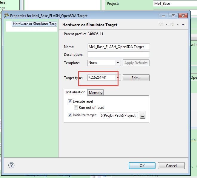

I got thr MKL16Z64VFT, that is a 64K flash. On the chip itself I read M16M6VFT.
Using the development SW, I can program only 32K of program.
What am I doing wrong?
16,517 Views

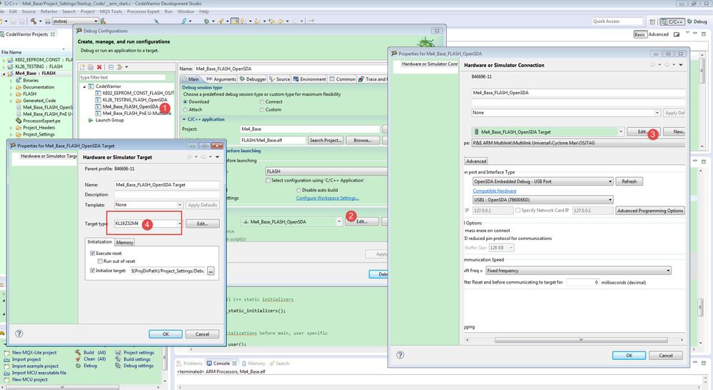

kerryzhou
Hi David R,
    I already find the root problem, it is really very difficult to find it if you don't give us the project.
    Your problem is not caused by the chip hardware, also not the code itself, it is caused by the debug configuration in the codewarrior.
    You select the KL16Z32M4 not the KL16Z64M4, then the debug will use the 32K to debug your code, after your code larger than 32K, it will have problem.
  This picture is from your debug configration: run->debug configuration
Please modify it to MKL1664M4.
After you modify it, then click ok, and debug, your problem will disappear!
Wish it helps you!
If you still have question, please contact me!
Jingjing

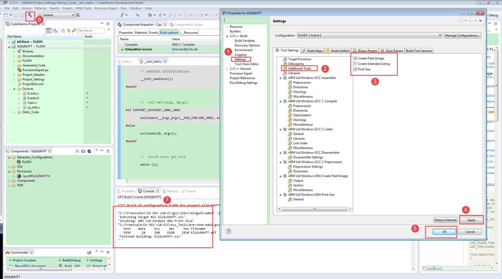

kerryzhou
Hi  David R,
    Please follow this picture, and printf the project size information:
    Then give me your project size information picture , data+bss will use the RAM size.
    You should better give us your project, then we can help you to check it whether it is caused by the copy to ram function or not.
    After we get your project, you can delete the attachment.
Jingjing

the print of the size is below
"C:/Freescale/CW MCU v10.6/Cross_Tools/arm-none-eabi-gcc-4_7_3/bin/arm-none-eabi-size"  --format=berkeley -x -t Me4_Base.elf
  text  data    bss    dec    hex filename
0x7cec  0x38  0x4cc  33264  81f0 Me4_Base.elf
0x7cec  0x38  0x4cc  33264  81f0 (TOTALS)

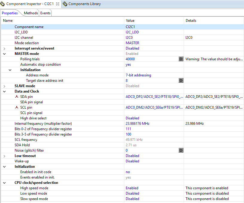

I checked a it and it handles very wierd, I wrote code for EEPROM I2C and it worked , but after I go over 32K this code stops running and throws Hard Fault ( I can see it in debugging step )
The problem is the SendBlock function, when I remove it the code is running ( same behavior with sendChar).
My code is very simple:
CI2C1_Enable();
// set address
res += CI2C1_SelectSlave(0x50);
res = CI2C1_SendChar(buffer);//setting read address
my I2C settings ( I tried with/without Interrupt)
do you have any suggestions ?
