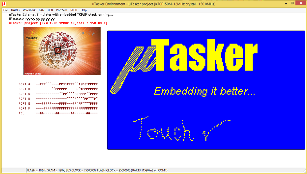

mjbcswitzerland
Specialist V
See http://www.utasker.com/docs/uTasker/uTaskerTouch.PDF
Code for K70 and TWR-LCD is included in the uTasker project at http://www.utasker.com/forum/index.php?topic=1721.0
Search for SUPPORT_TOUCH_SCREEN in the code and the settings for K70F150M_12M.
Initialisation is fnStartTouch() in glcd_tft.h and the interrupt is handled in fnTouchInterrupt().
The touch operation is also simulated in the uTasker Kinetis simulator - as show in screen shot below:
Video of the operation: https://www.youtube.com/watch?v=PvsFFRigwFU (same operation on TWR-K70)
Mark
