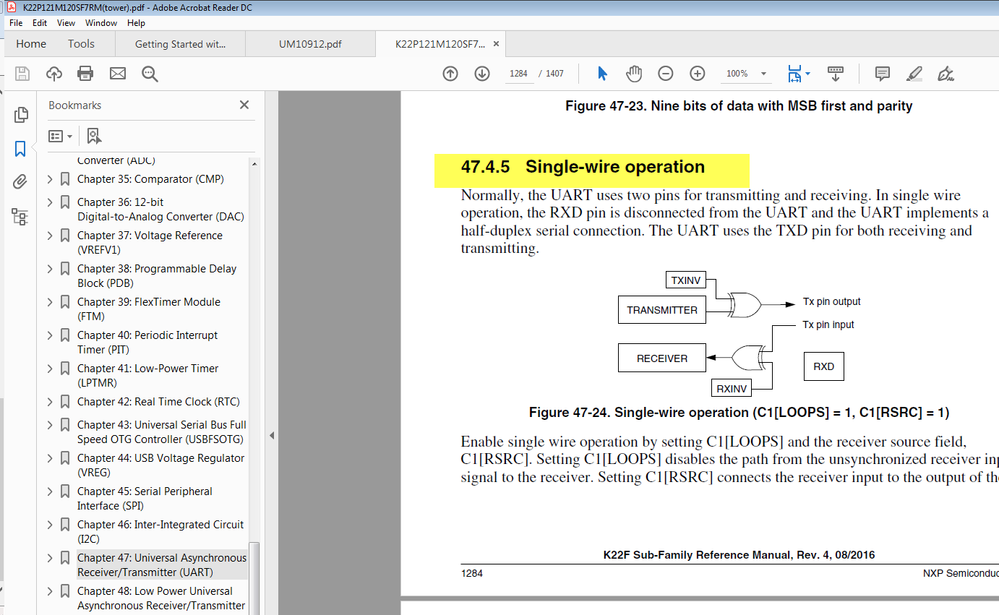

kerryzhou
Hi Javier Hernandez ,
  Please tell me which kinetis chip you are using? Tell me the chip part number, I will help you to check whether that chip can support the single wire UART or not.
Some kinetis chips UART module can support the single-wire operation, about the document, you can refer to the chip reference manual directly.
Take K22 chip as ane example:
You also can check your kinetis chip reference manual by yourself.
Wish it helps you!
Kerry

kerryzhou
Hi Javier Hernandez,
    Thank you for your updated information.
    So, please refer to the KL05 reference manual, chapter:
   37.3.4.3 Single-wire operation
  This chip UART0 also support the single-wire operation.
Wish it helps you!
Kerry
